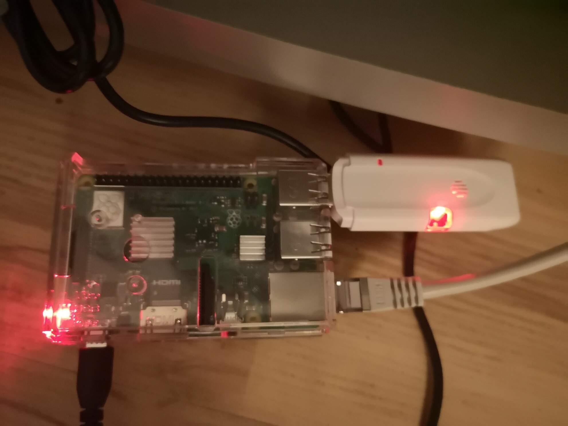

So I started with a Raspberry, a Z-Wave USB Controller, a Fibaro Switch and some z-Wave sockets four weeks ago:

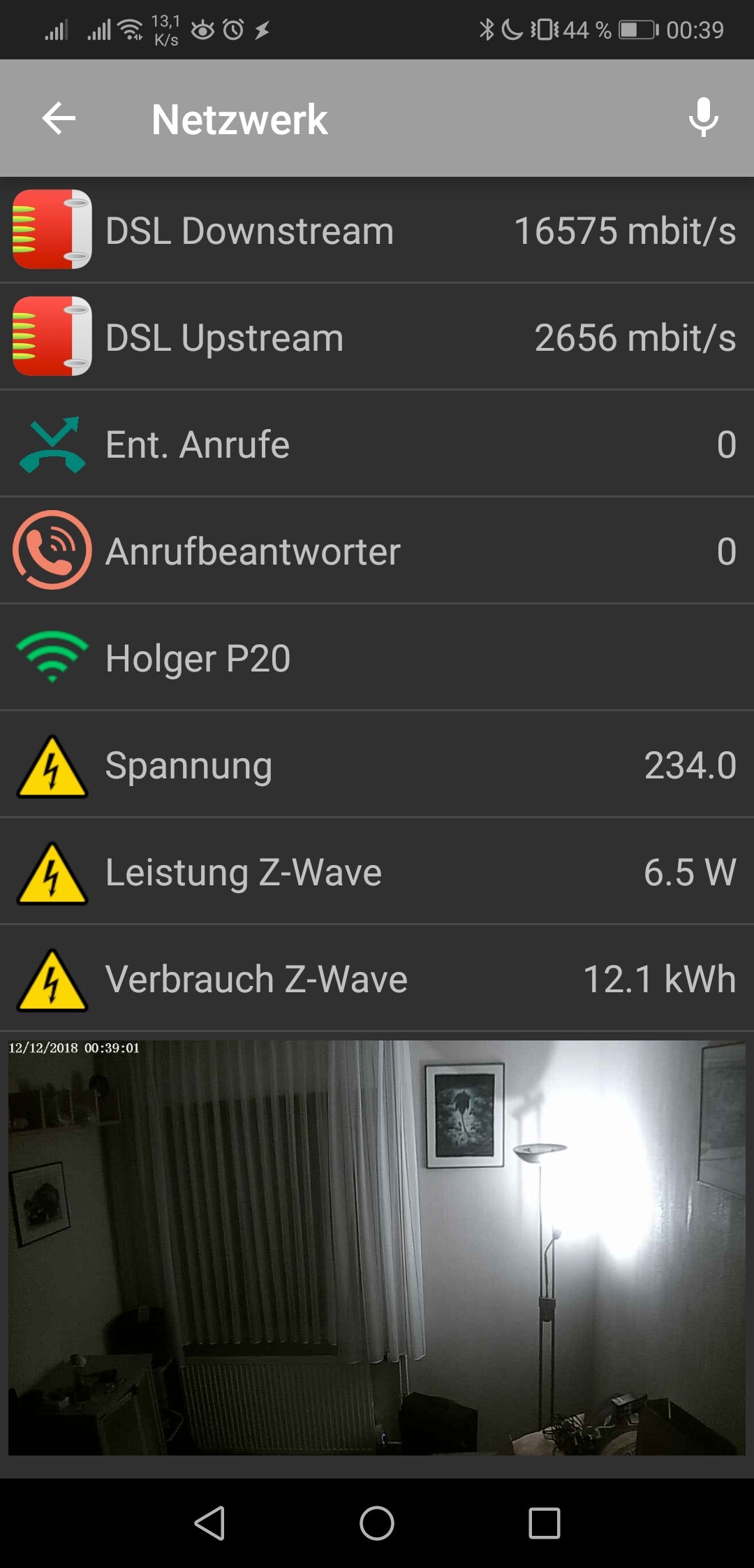

It did not take long to make things work, and even at this time I already tried to make a nice sitemap with infos. I even managed to add a “live view” from a old Foscam IP camera:

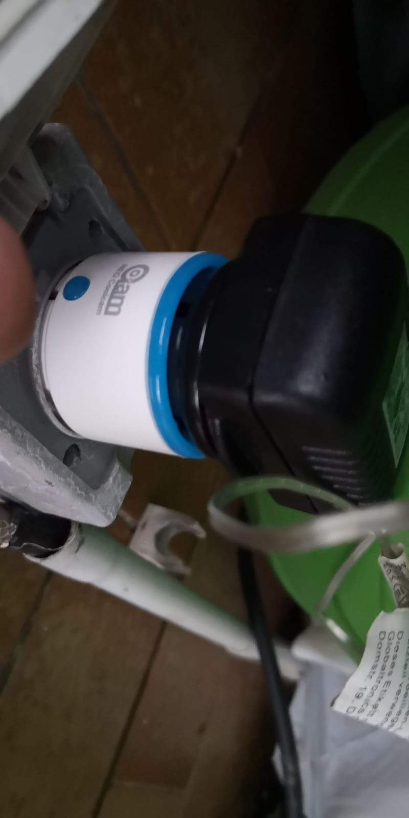

I realised that Openhab quickly makes addictive. So when December started, I bought a cheap Z-Wave socket to control christmas decoration outside (yes I know the socket is indoor use only, but it is protected from rain).

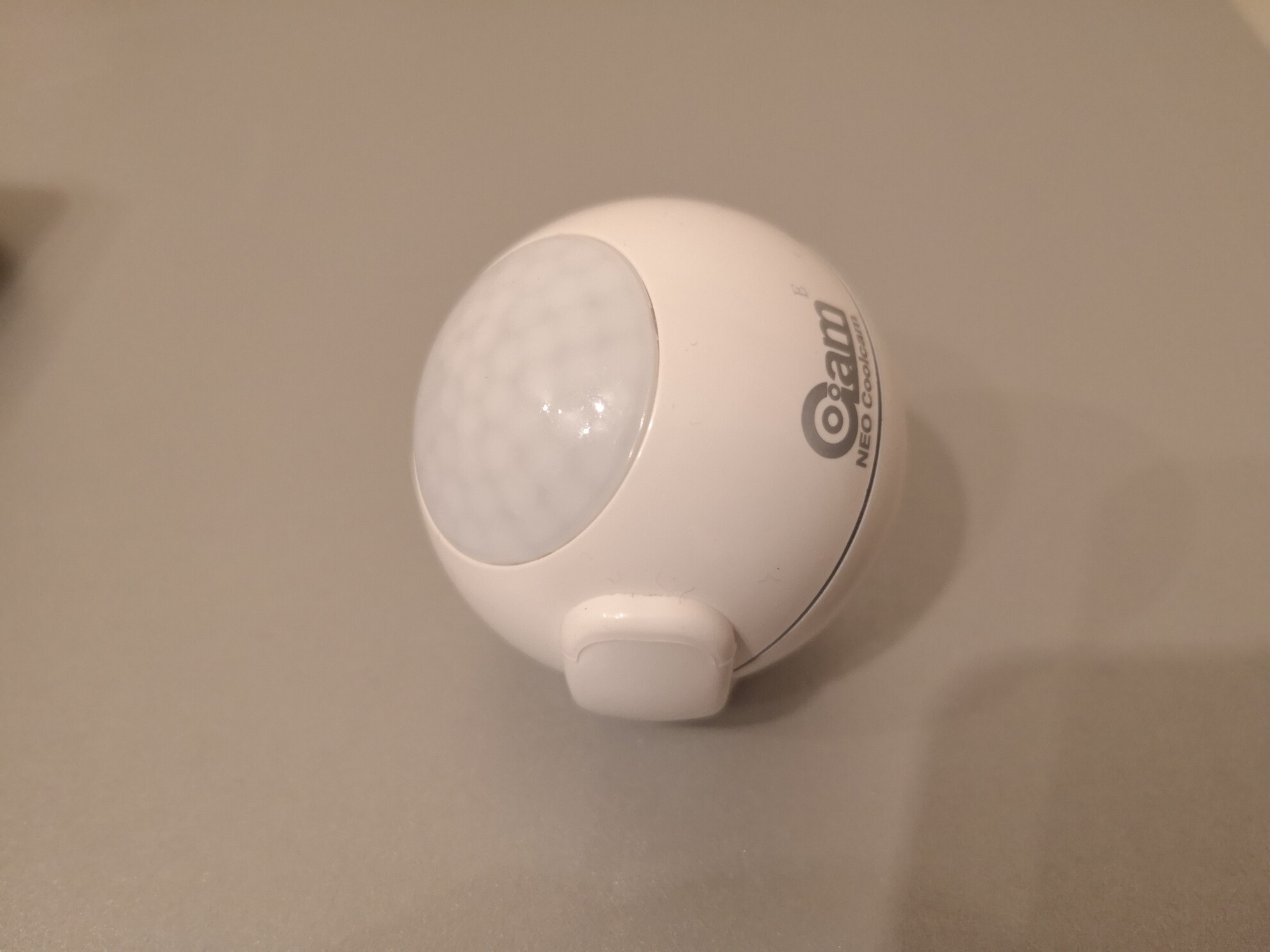

As I want to automate certain illumination later, I bought a Motion Sensor for testing:

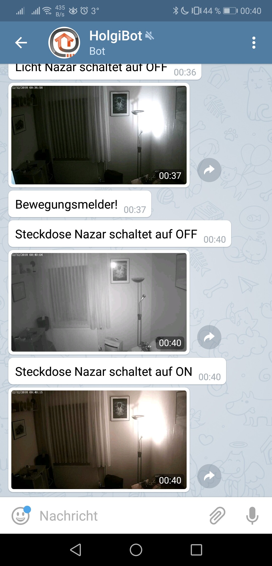

As there is nothing to switch with it at the moment, I used Telegram binding to let it send alarms. Telegram also sends snapshot images when lighting change (just for fun :grinning: )

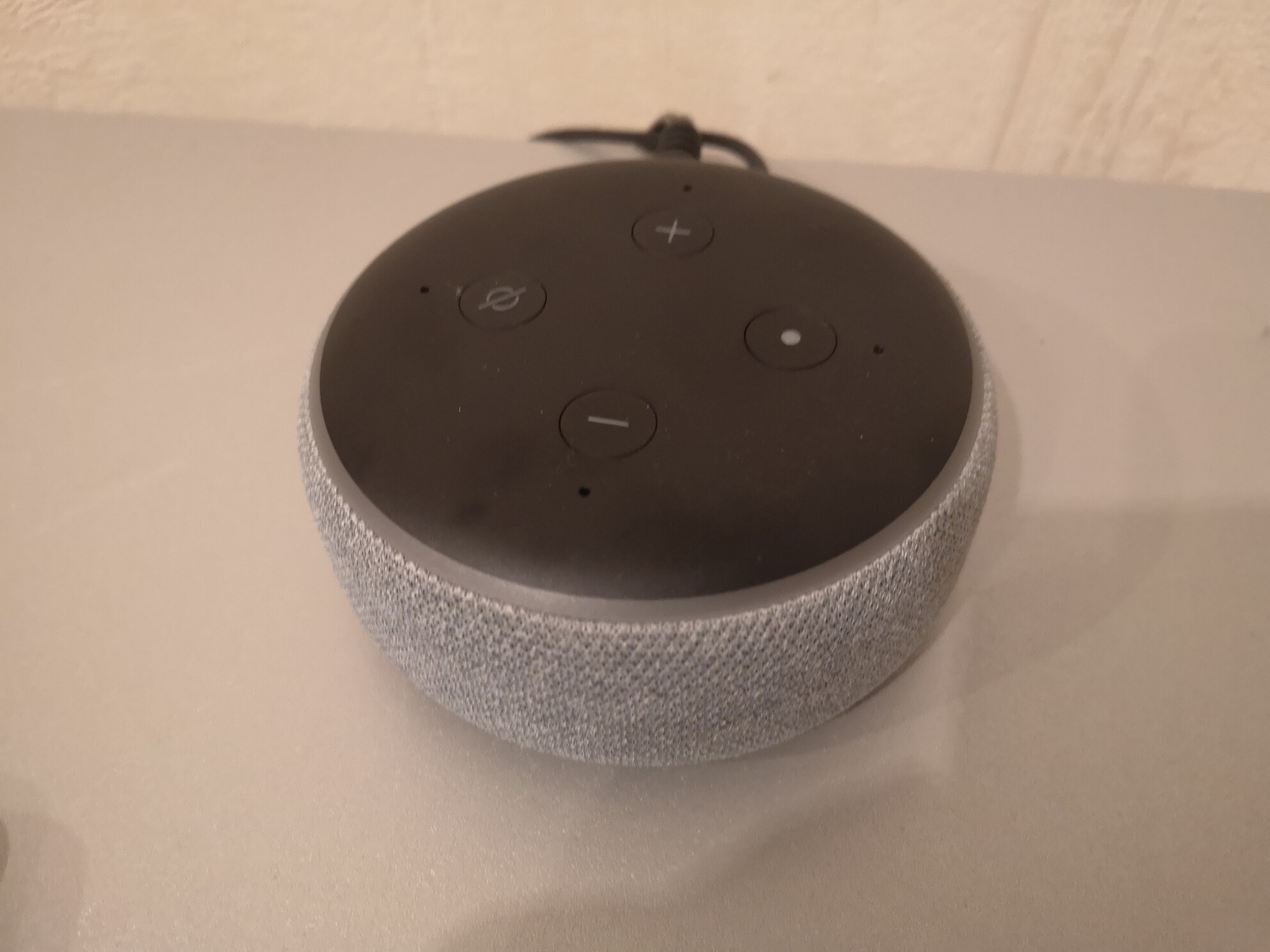

Of course I want to have Alexa integration, so at Black Friday week I bought some Echo and Echo Dot. Thanks to Openhab Cloud, no hazzle to integrate.

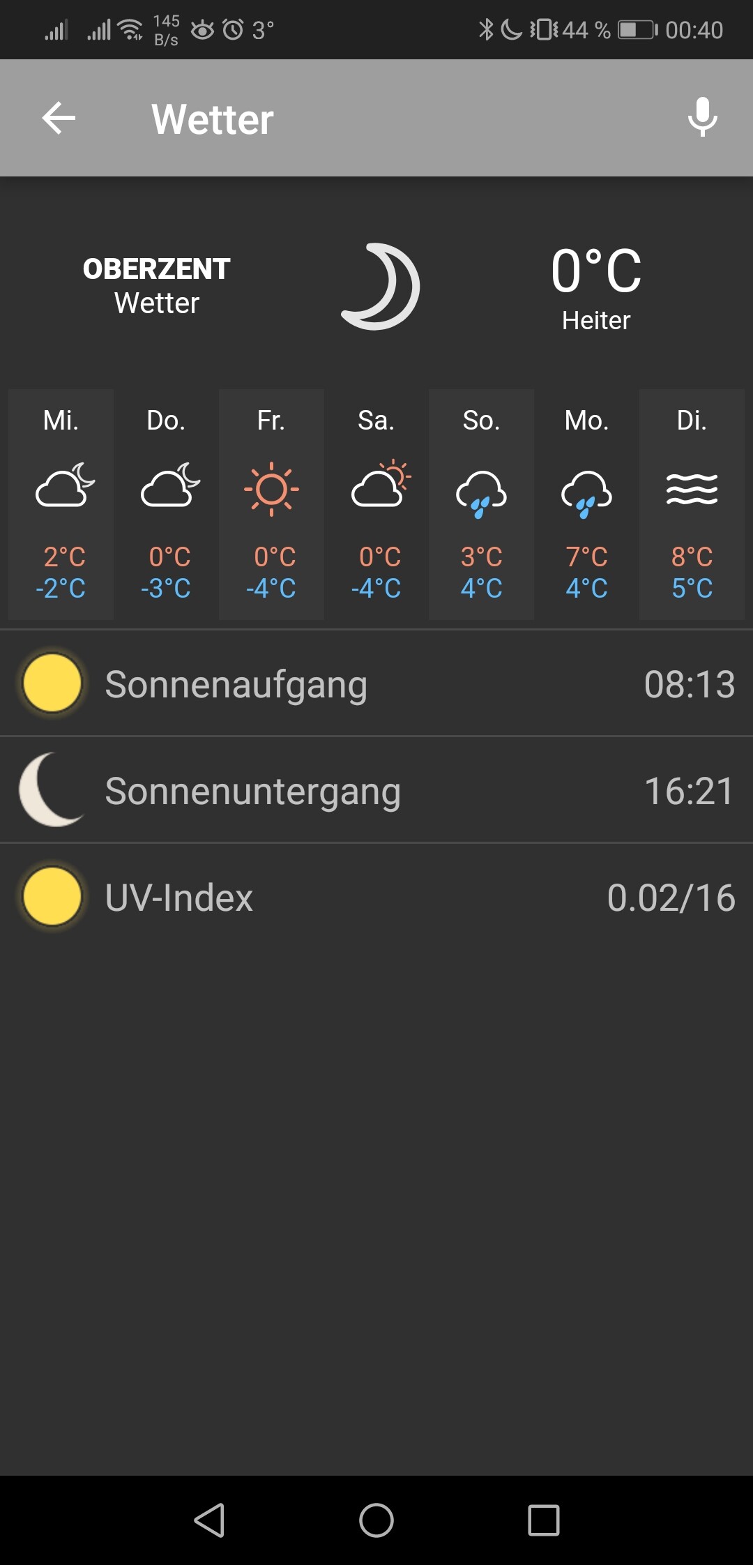

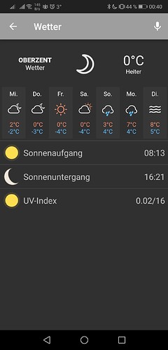

In the meantime, I always improved my sitemap, for example with a nice weatherwidget:

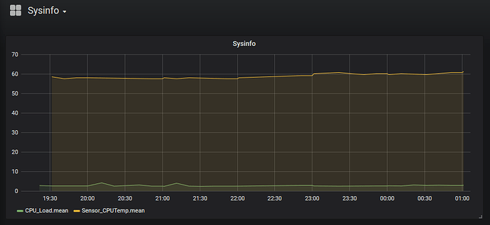

I also set up Grafana to be able to make some graphical analysis later (so far only some Sysinfo items).
