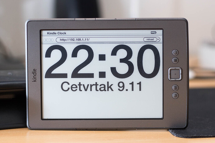

Ok, here are some images :stuck_out_tongue:
“Simple” and easy project, bought old kindle (v3 or 4 not sure) loaded simple javascript in browser that will display the current time and date.
Plan is to make custom wooden frame, but… time will tell.
It is big and easy to read, can show temperature (but now my server is on/off so for now page runs completely offline. It has battery that holds weeks (although it is on charger all the time).
And most importantly, it doesn’t tick, and it doesn’t glow in the dark (which really drives me crazy). Newer kindle versions can hide addressbar in browser, but this works fine as well

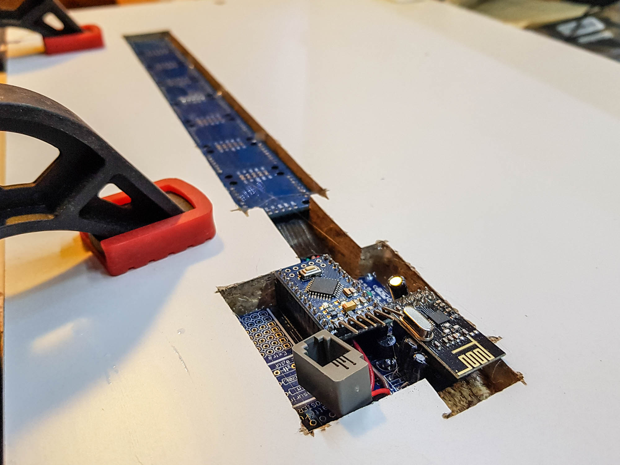

My wife said she doesn’t want to see “those things”…
Challenge accepted!
TV%20LED%20display%203%20-%20small%20-%20MVI_5770-2-cropped
Nice!
What kind of material is the front of that door and how did you dont cut trouh the material?
That is pretty awesome!!
I asked the same question on a PM to keep the tread clean. He cut through and then covered the front with wall paper.
Correct, I did cut it trough and glued the display as flush as possible with the front, then put two sheets of self-adhesive wallpaper on top (one tip for next time, individual displays are not perfectly soldered straight, so they are noticeable, in front of all displays put one sheet of plastic to keep the foil straight). I got inspired from this https://www.youtube.com/watch?v=2P-8-zd7sXg where he uses venier (i guess very thin wood, not sure). But since I have relatively large area, and it was white (and I found white decoration wallpaper) for me this worked fine.
Since the doors should still be functional, I used old phone “curled” cable for the power, and attached it to the top of the shelf and the doors (not to tension the connection). It is a bit tricky opening the doors, but we rarely do it as all electronics for media/tv is inside, so nothing to see.
Display is driven by MySensors arduino library, that communicates with openhab/node-red.
All in all a relatively easy project to be honest, display logic was most difficult part as radio(or mySensors?) is limited on amount of data it can receive/send, so I spent a lot of tweaking to get unlimited text, also have it display correctly etc. Node red is doing some magic there, and openhab is providing the data. Great wow-factor vs. time spent balance :slight_smile:

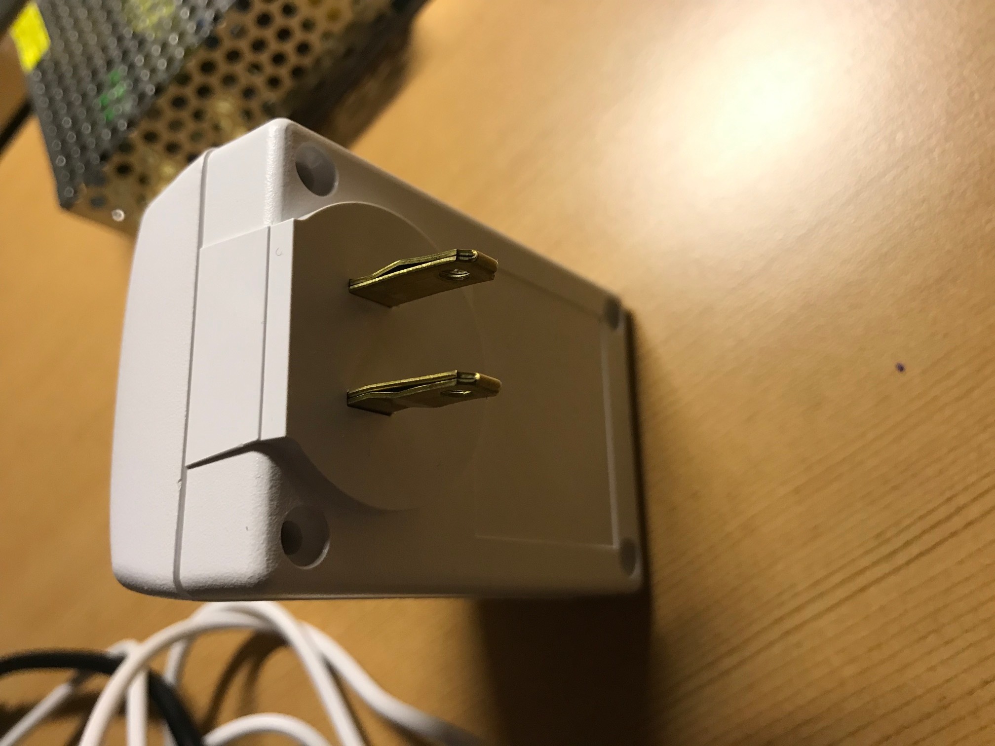

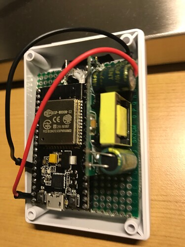

One frustration I have had is making our homemade IOT look good. For ESP32 bluetooth presence detection, I found these plugin cases https://www.polycase.com/gs-2315
I added a simply AC/DC powersupply and the ESP all in one nice package.

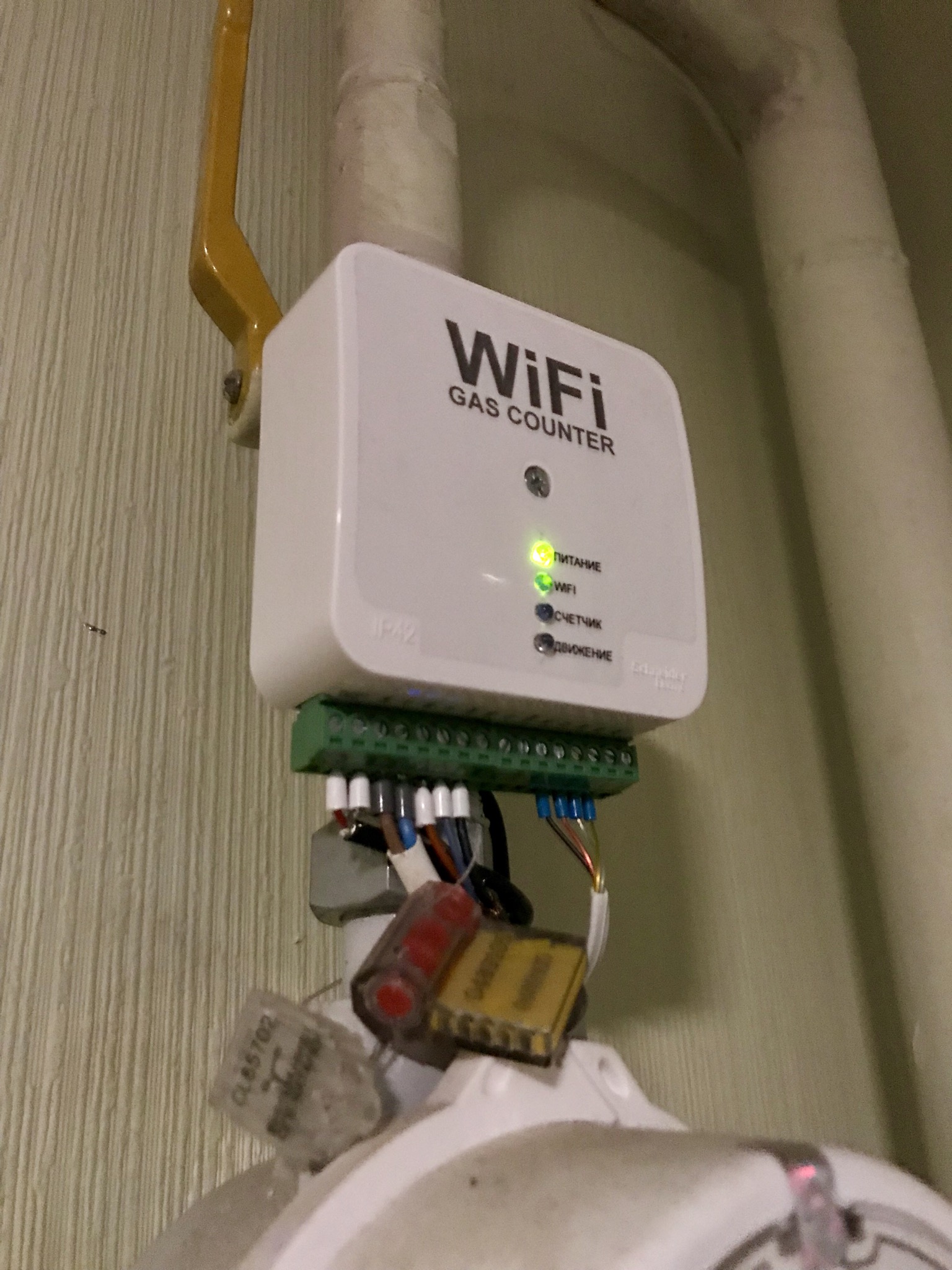

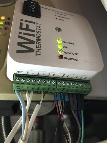

Here is mine. Esp8266 inside, EspEasy firmware, plastic case is Schneider Electric wiring box with sticker.
It has relay (for boiler), temperature, leak, motion sensor, MQTT Connected.
