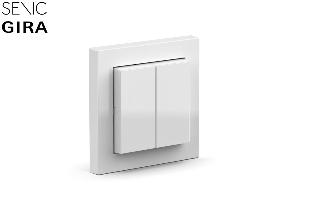

I can recommend the switches from Senic/Gira. Thanks to energy harvesting, no batteries or power connection are required. You can simply put it anywhere and the buttons can be freely assigned with openHab

As already described a two-gang switch is a surface mount anywhere on any flat surface, doesn’t need batteries, looks good (you can get some very smart - and expensive - surrounds) and gives you four buttons (up and down for each of the left and right switch) and with a little coding you can generate different responses for long or short presses.
I have these where I can’t get power for Z-wave switches (or don’t want to rip the walls apart - retrofitting automation to a 300 year old house is not fun). You can stick one to the wall on each side of your bed and both have remote control.

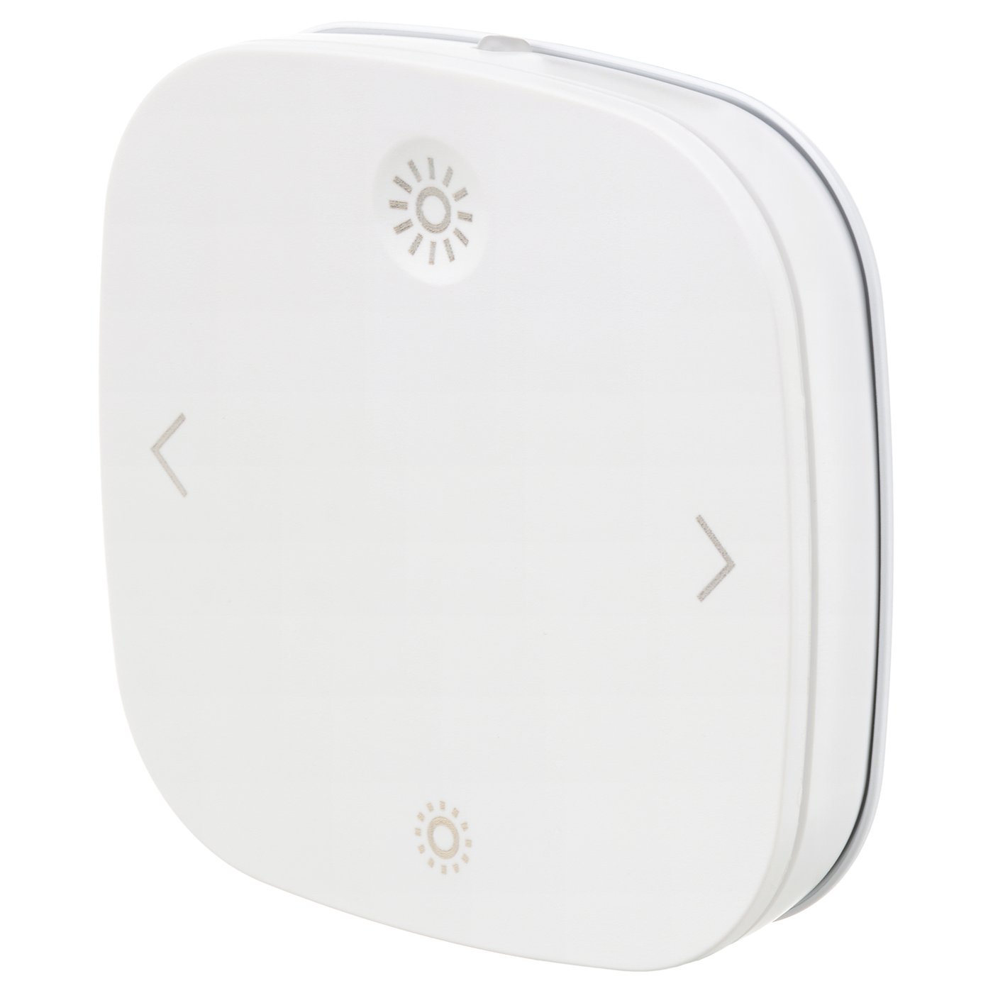

I think about buying Tradfri stuff every time I’m in IKEA, but I haven’t gotten into Zigbee (and now I’m waiting for Matter/Thread).
I see they have a new remote control out that looks pretty nice.
