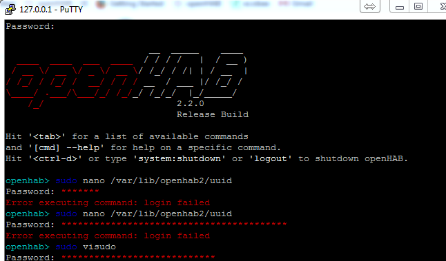

What is the password for a sudo command
i tried openhab, habopen, password, my loginpassword for my pc. none of them will work. can somebody help?
sudo is a command on linux console.
With your image above, it’s in karaf console, not in linux console. So, sudo command does not work.

But I should add that this has nothing to do with the karaf console.
To run sudo commands and the like you need to ssh to the regular ssh port on the machine OH is running on.

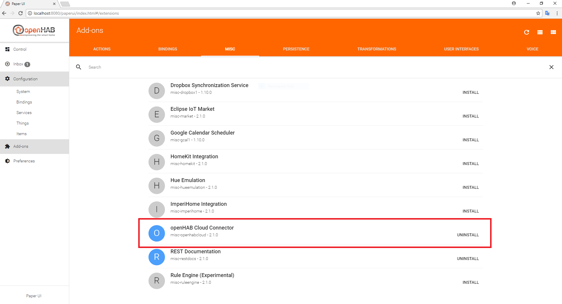

Do you want to find uuid file and secret file of openhab on Windows PC ?
If yes, first, install openHAB Cloud Connector (misc-openhabcloud)
And then :
  • uuid file is in (openhab-folder)\userdata\
  • secret file is in (openhab-folder)\userdata\openhabcloud
There is no such thing as sudo on a Windows machine.

How about telling on what System you are running OH and from what System you want to connect to OH.
In the Picture you posted in the second post you are connected to OH, more precise to the Karaf-console, this Connection is made via Putty to “127.0.0.1” in other words you were making a connnection to OH from the System on which OH is running.
If your OH would be running on a Linux based System, you could have used sudo commands in that Putty window BEFORE starting the Karaf-console! Or in the aboveposted Situation just Punch in “logout”!
However since your OH is installed on Windows that all does NOT work!

Thanks, I just did the logout and it did work. Thank you again
