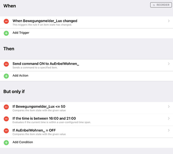

You can do this via the rule editor.
Should look like this:
Your trigger (When) is when the lux value changes.
The action (Then) is your light you want to turn on.
The condition (But only if) is the lux <=50, the time range from 4pm to 9pm and the state of the light (if it is already ON there is no command send to turn it on again)
Best regards
Dirk
A slightly better test for blocking if the light is already on is to test equal !ON, i.e. not-ON.
Items may sometimes have state NULL or UNDEF as well as the usual ON/OFF
