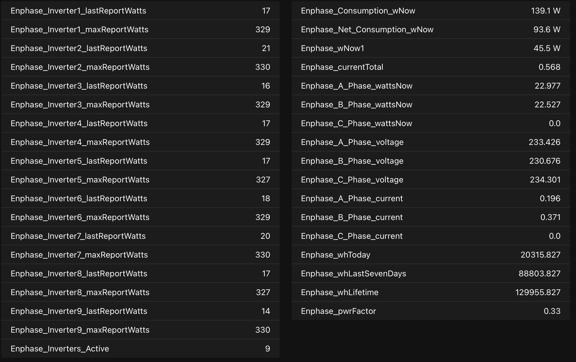

Another option is the Enphase products, HTTP binding and JSON transform. Just setting my one up now, there is heaps of very granular data if needed.

George, what you have done there is just what I am trying to do!
I’m new to openHAB but have managed to configure the Enphase production output. Regarding the inverters I have the http url Thing fetching the json, but I’m struggling to get the correct JSONPATH expression to cope with the multiple inverters.
Are you able to share your solution? Thanks
