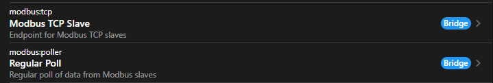

I have a Sofar inverter (HYD EP 5000) with 2 batteries (GTX5000) and I read the inverter via Modbus. Actually I bought a device from Waveshare which is connected to the inverter and converts the Modbus data to mqtt. Everything is working fine :smile:
The Waveshare converter just translates serial to Ethernet, just like you need to do with any Modbus device that doesn’t have an IP interface.
But now that you have direct Modbus access why don’t you use the Modbus binding but convert to MQTT ?
Because my openHAB device is not close to my inverter. And I would need a serial to usb device. There are probably better approaches, but this was the easiest way for me.
The device you showed is a serial to Ethernet converter so you don’t need any serial to USB, you can simply use the Modbus/TCP binding. Point it at the converter’s IP.
oh, that’s what you mean. I will certainly try this, never thought about it.
I asume I need these 2 things:
