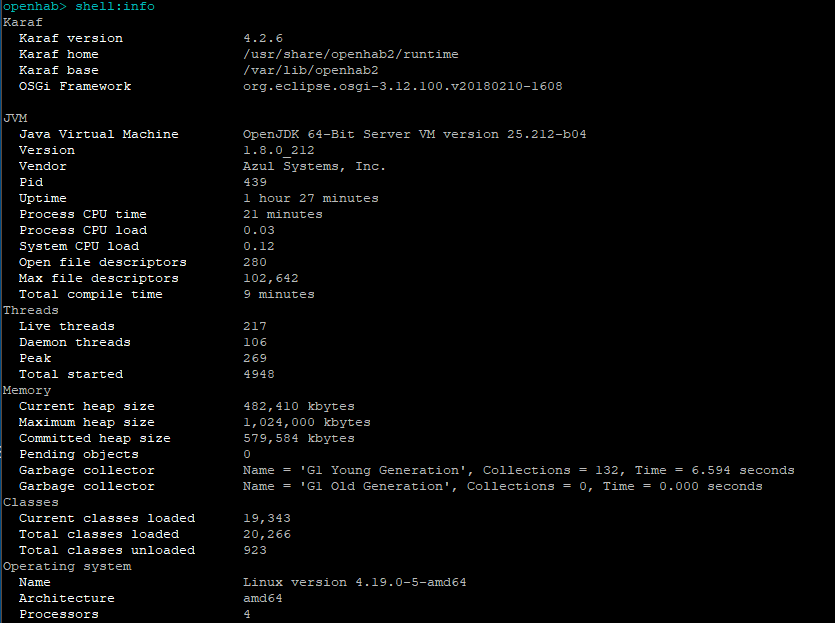

Personally i increased both values -Xms to 500m and -Xmx to 1024m
To make the information mor complete. Running a VM on my synology with debian

Sounds like that will be fine, but it would be interesting to know what range your heap size shrinks and grows between instead of a static known number from your pic. There is no perfect number, it is just you need to make sure you don’t run out of heap space and also don’t set it excessively high.
