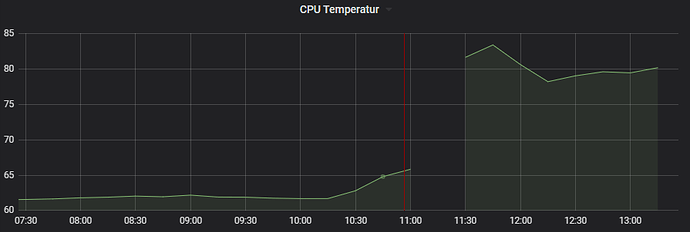

usually the CPU temperature of my cased Pi 3 (with cooling kit installed) was around 60°C. Recently it went up to >80°C - I removed both the case as well as the WiFi and Z-Wave Stick, but it still goes up to 75°C, which I don’t think is healthy.

I checked the past CPU temp in Grafana and noticed that the temperature went up when I activated the amazonechocontrol binding.
I uninstalled the binding and now the temperature is back at ~60°C…

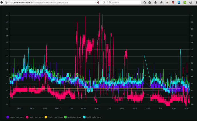

I have several raspis running at home, 2 of them on openhabian, and had heat and power-issues at first that were not noticed. I wrote a little python script to monitor them so I can see their state and health on a habpanel page. You can find it on GitHub - planetar/pi-health.service

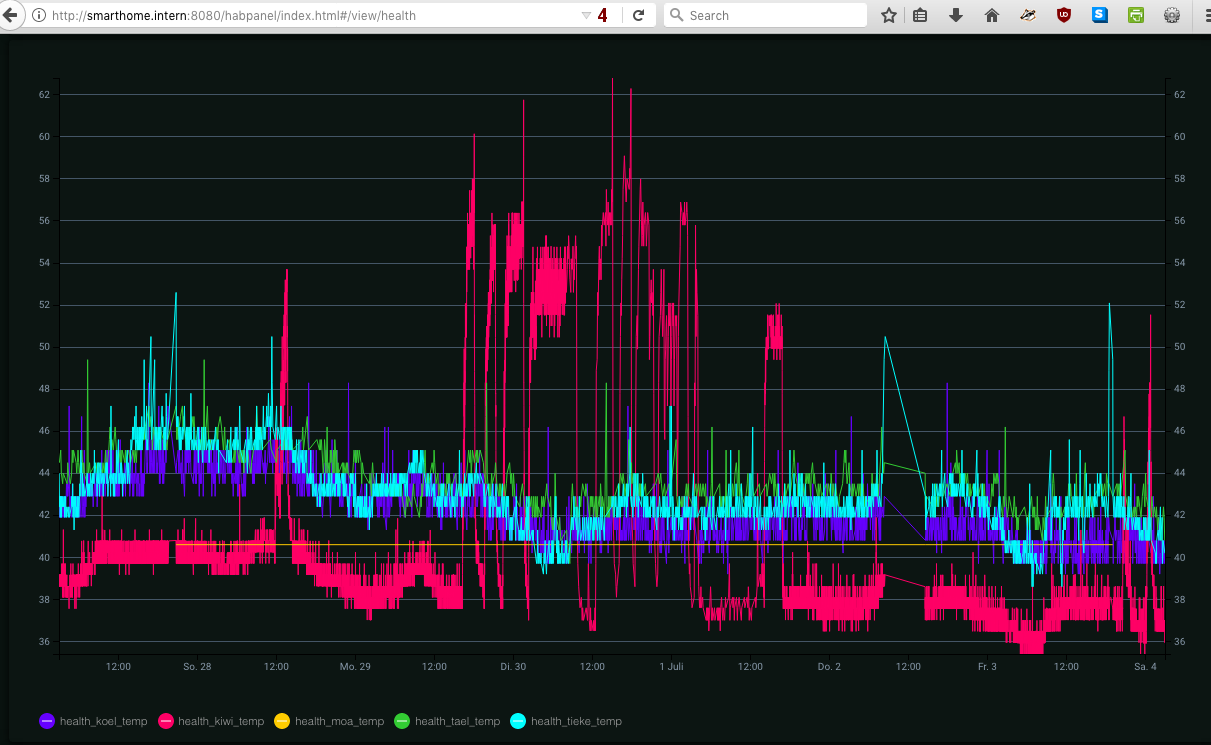

I put a screenshot there showing the temperatures of my raspis floating between 32 and 50 °C with the mean around 40°C
This script is intended to run as a daemon on a raspberry pi with raspbian or a derivative like octopi, openhabian etc. It collects cpu health data including temperature, frequency, throttling, under_voltage, cpu-load, memory use and post them to an MQTT broker. Namely when a number of raspberries are active like in a smarthome setup or with several 3d printers on octoprint this helps to survey the well being of those raspis and integrate their state on a dedicated page, i.e. with openhab2 and the mqtt binding.

So the last week I ran OH without using a case and the temperature was between 60° and 65°.
I just put it back in the case and it went up again to >80°.
I mean it makes sense that it’ll go up, but more than 15° seems a bit weird, doesn’t it…?

The red one is an octoprint server with a huge (8010) regulated fan but when it’s busy it shows.
OH2 runs on the turquoisie colored, a small fan @ 3V in a very open case. It seems to run cooler after I migrated my rules from DSL to jython. It is a raspi 3B+ while all the others are 3B
