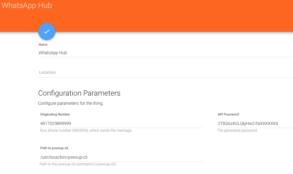

It’s still running, so I started working on a first version of a binding.
I update the install doc above to include macOS (my dev environment) and already get it running (make sure you run with python2 not with python command to execute setup.py).

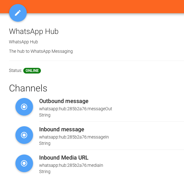

@dan12345 First messages send and received :slight_smile:
If you are interested I could provide an alpha1 tomorrow. I’ll add some documentation and want to discuss some design aspects.
PS: I looked into support for media files, but this is not yet in the focus. You get an url to an encrypted file, so the plan might be to download the file, decrypt it and then provide the URL to the local file to an item, which can then be processed in a widget etc. to get displayed to the user.
