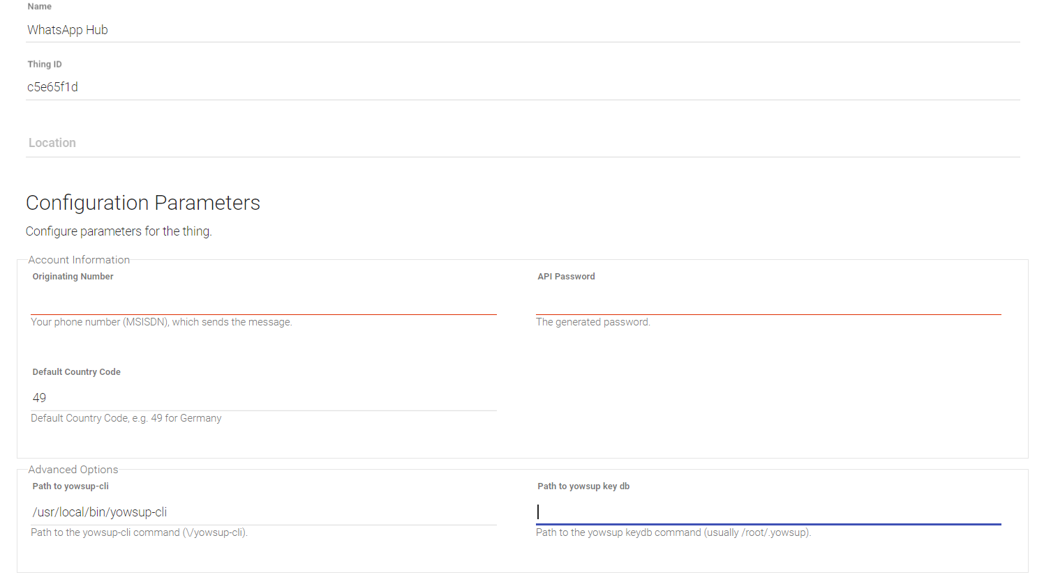

Where do I get the key db path and API key?

And I’m currently unsure which steps the binding already does, and which I should do myself.
I can read the instructions on the top of this thread, but what does the binding do of it automatically yet?

Just read the readme on the GitHub repo, it’s pretty well documented.
Thanks marcus!
Deleted the .jar addon and the item and will start digging into it when my SIM card arrives
