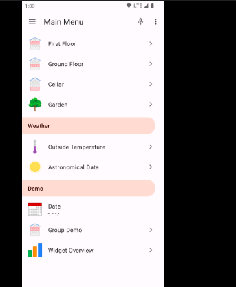

When i start the app on android, i see a “main menu”, with more a classic style
I also see the “main ui”
“tested with demo mode”
But what i’m after is the “Main Menu”, this one runs better on older android systems… where can i see this in Openhab itself? how to add items there? i only just created 2 things now, but they only show on “main UI”
This is NOT what i want:
looking for this style:
These are called Sitemaps and are created using text files.

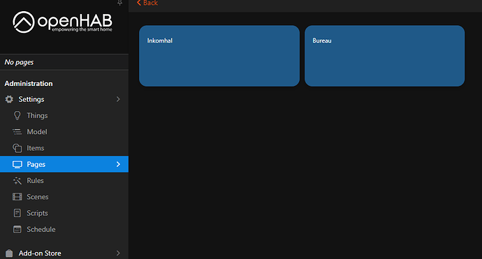

ok, created an sitemap, i inserted my 2 lightbulbs on it , so far so good

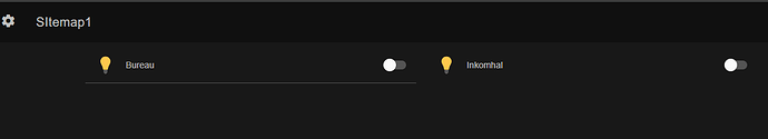

however , on the sitemap, the lightbulbs, they work when i do then on/off, but seems the state is not changing, if i change the lght itself?
i see a “?” in the state icon

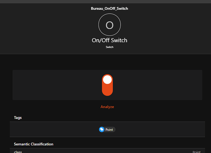

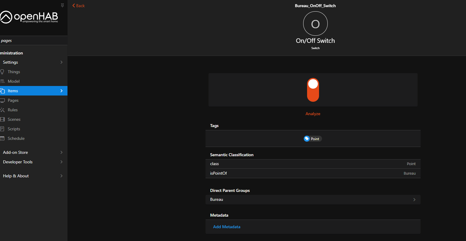

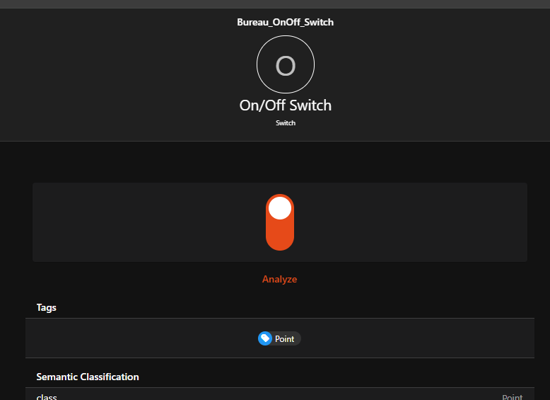

within items, the state perfectly changes:

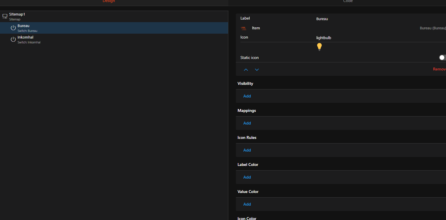

Change the icon to light, not lightbulb.

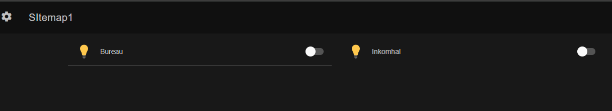

i changed to “light”, but doesnt help, i see state is now “on”
but on basicUI is off
please go to the code tab of the sitemap and post the code here in code fences.
It is hard to tell from screen shots.
here is sitemap:

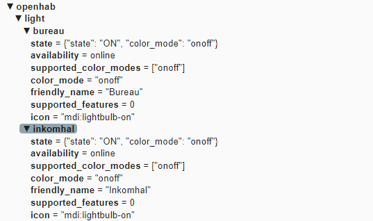

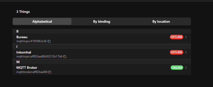

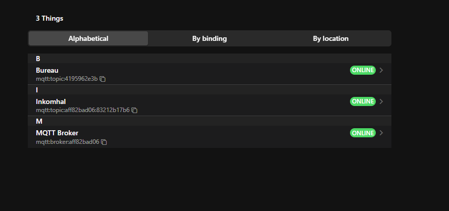

What i also notice, if i reboot Openhab, the mqtt device go to offline, untill i turn on/off my light itself? why doesnt it detect the online state? in mqtt they are online?
after reboot:
but in mqtt still online
