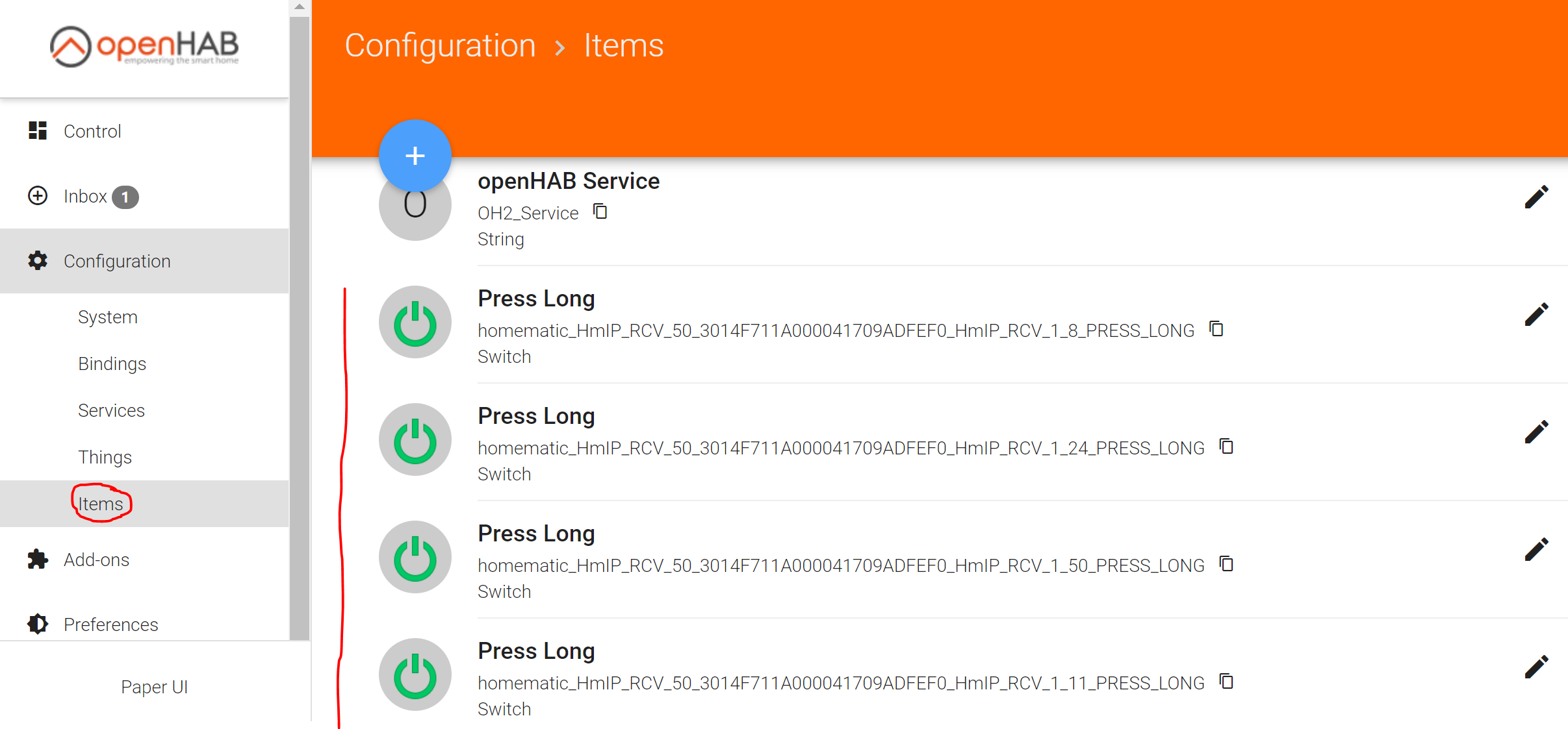

At the beginning of my openhab “careeer” I had “Simple Mode” switched on. A while ago I switched it off and unlinked a lot of items I do not need anymore from things.
However, a lot of items still remain in the repository which cannot be deleted via PaperUI, via REST API nor are they stored in my .items files.
Could anybody please guide me to the correct where to delete these items?
