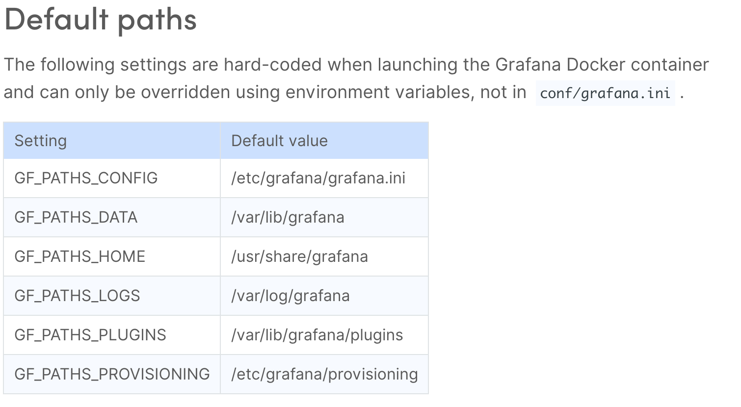

Now I am looking for the grafana.ini file because I would like to disable user signup and enable anonymous access for image export.
I have seen that you need to create bind mounts with the below links.
I do not know how to link the above without ruining my existing setup.

It’s probably best to use environment variables as the documentation suggests.
To fix things you could do this:
# Stop the existing container
docker stop <your_container_id>
# Copy your data to its new home
docker cp <your_container_name>:/var/lib/grafana/. /my/grafana/data
# Start a new container using a bind mount and new config
docker run -d \
-p 3000:3000 \
--name=grafana \
--user=<your_user_id> \
--volume "/my/grafana/data:/var/lib/grafana" \
-e "GF_USERS_ALLOW_SIGN_UP=false" \
-e "GF_AUTH_ANONYMOUS_ENABLED=true" \
grafana/grafana:latest
