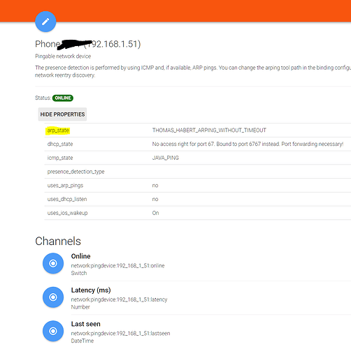

This is from an iPhone X:
Graph is this item:
Switch Phone2 (lanItems, presenceDevices) { channel = "network:pingdevice:192_168_1_51:online" }
