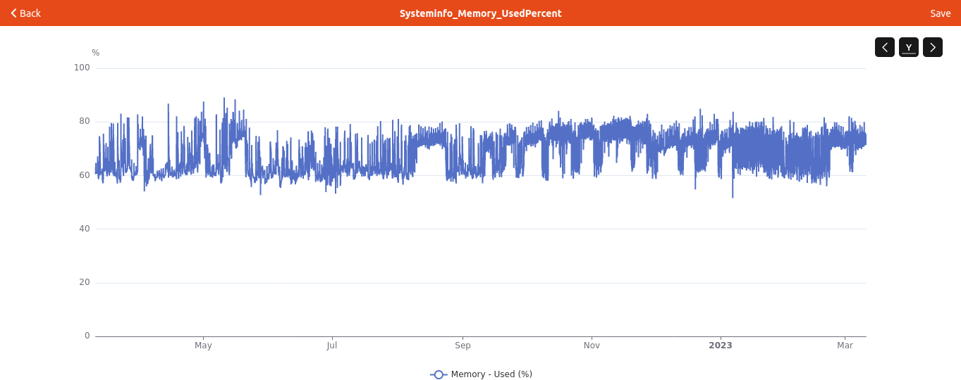

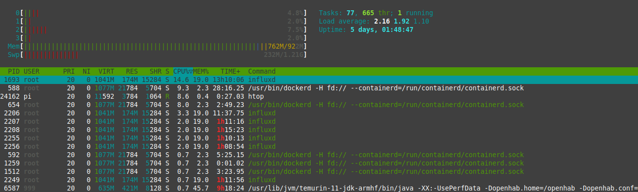

I thought about this as well, but the way I read both htop…
… as well as the sysinfo-binding…
… it’s not that I have a huge margin left, but I’m also reliably not in an area where RAM has to swapped onto the really slow SD card. Or am I interpreting the readings incorrectly?
You’re referring to the different logging levels, correct?
That htop screen shot shows you are using 232 MB of swap. That’s 232 MB of stuff that should be in RAM but isn’t.
No, in developer tools in your browser you can see what MainUI is doing. Then yes, you might need to go into debug or trace logging in OH core and the bindings in question.
But the fact that your system has swapped out 232 MB, I’m guessing that’s the root cause.

Why do you have 7 influxd processes each consuming memory? I only have one. :slight_smile:

Good question. II assume I did a pretty standard docker install. Any idea how I can check why this is the case? Besides the strange entries in htop, I do not experience any other problem.
I’m sure there are settings in InfluxDB to control how many processes and threads it is allowed to use. But that will largely be outside the scope of this forum. I find the InfluxDB doc to be pretty decent though.
I don’t use htop myself that much, apparently it shows all threads by default which is customizable with “Hide userland process threads”, see:
https://www.baeldung.com/linux/htop-ps-more-processes#1-user-threads
