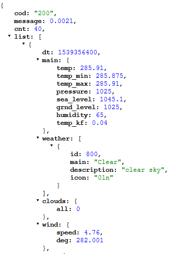

Sorry i’m newbie. I do not quite understand what is meant with that:
I tried the browser-site with my key: http://api.openweathermap.org/data/2.5/forecast?id=524901&APPID=mykey-1-32
in this case and got this back:
so i think it should work.

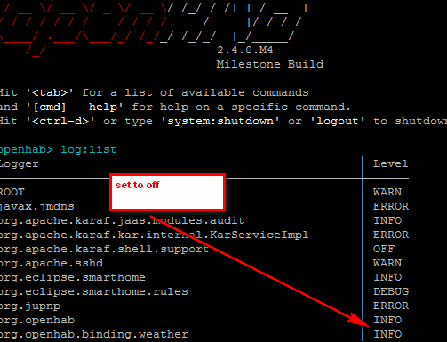

So if you have no idea, i will set logging to OFF:
to ignore when data is coming.:wink:
