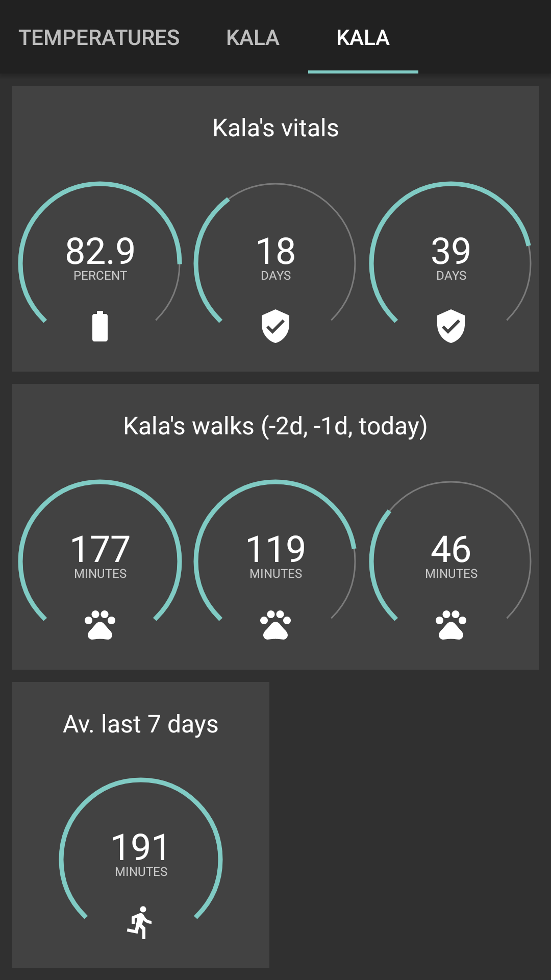

Using the rotini client, these are a few of the values available:

Items:
Number whistle_01 "Current goal [%d]" { whistle="999999:goals:current" }
Number whistle_02 "Longest goal [%d]" { whistle="999999:goals:longest" }
Number whistle_03 "Average activity level last 7 days [%d]" { whistle="999999:averageactive:7" }
Number whistle_04 "Average rest level last 7 days [%d]" { whistle="999999:averagerest:7" }
Number whistle_05 "Average activity level last 30 days [%d]" { whistle="999999:averageactive:30" }
Number whistle_06 "Average rest level last 30 days [%d]" { whistle="999999:averagerest:30" }
Number whistle_07 "activity:2 days ago [%d]" { whistle="999999:activity:2" }
Number whistle_08 "target:2 days ago [%d]" { whistle="999999:target:2" }
Number whistle_09 "activity:1 (yesterday) [%d]" { whistle="999999:activity:1" }
Number whistle_10 "activity:0 (today) [%d]" { whistle="999999:activity:0" }
Number whistle_11 "device:battery [%.1f %%]" { whistle="999999:device:battery" }
Config:
whistle:username=name@email.addr
whistle:password=YourPassword
whistle:refresh=1800000
