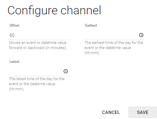

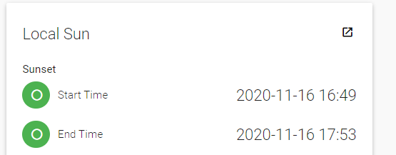

In the paper ui i had set an offset of 60 minutes for the End of Local Sunset but still the roller is going down at the old time, in the Control of Paper UI i see the right time but the roller starts an hour earlier at 16:53

Which Channel did you ally the offset to? You need to apply it to the event Channel.
I did it on the channel of astro:sun:local:set:end
What is the event channel ?
Do you have a example for me ?
You need to do it on the Range Event Channel to trigger your rule
I am sorry but it cant put in a time in the range event at earliest or latest, when i put a time at earliest say 18:00 and 18:30 at latest i get warnings in the log like below
2020-11-19 15:43:42.882 [WARN ] [ng.astro.internal.util.DateTimeUtils] - Can not parse astro channel configuration '1970-01-01T17:30:00.000Z' to hour and minutes, use pattern hh:mm, ignoring!
2020-11-19 15:43:42.887 [WARN ] [ng.astro.internal.util.DateTimeUtils] - Can not parse astro channel configuration '1970-01-01T17:30:00.000Z' to hour and minutes, use pattern hh:mm, ignoring!
It is referring to the first of januari in the year 1970 ???
But i dont know why, from where is this coming ?
Btw, i am doing this in paper ui, i am not using text files.
It kind of looks like there might be a bug in PaperUI for setting the offset in this case. I’m not sure whether or how easily it would be fixed given that all development has moved to OH 3 now. I can confirm that it works in OH 3 and MainUI.
The 1970 is coming from the fact that a date is not being defined. A DateTime represents an instant in time. Almost all computers use something called epoch to represent time. Epoch is just a big number that is counting the number of milliseconds that have passed since 1970-01-01T00:00:00 (midnight on new years 1970 GMT). Since you only defined an hour and minute, which is all you should define, it defaulted the date time parts to 0.
The problem appears that it’s converting your input to a DateTime too soon.
You can file an issue (not sure if it’s a PaperUI or an Astro binding problem) and hope it gets fixed, upgrade to OH 3 where I know it works (which implies it’s actually a PaperUI problem), or stop openHAB, open the JSONDB things file and manually fix the entries to use hh:mm as the times.
