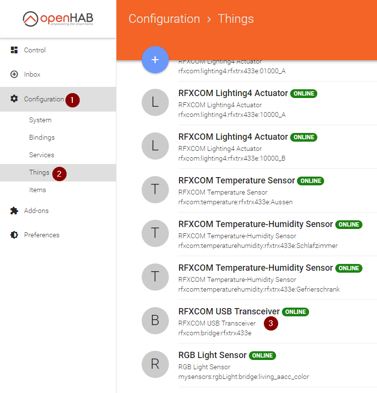

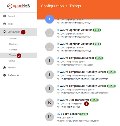

Because you already have configured your rfxcom gateway in the PaperUI, you can just continue to use that and reconfigure the gateway in the PaperUI. For that, please delete your rfxcom.things file again and go to your Rfxcom thing in PaperUI:

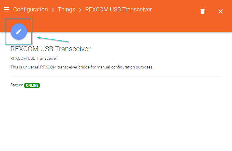

Then click on the Edit button:

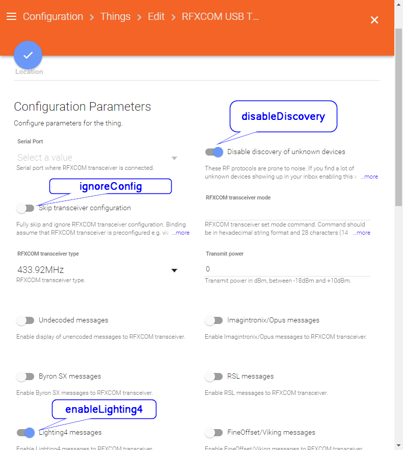

Here you can make all the settings I did in my textual config. I have highlighted some of them with the names I used in my config. Just flick the switches to your liking and click the tick on the top of the page to save:
Oh and disableDiscovery will just stop the binding from automatically adding new things to the inbox. My neighbors are using those lighting4 remotes a lot and my Inbox is full of things of them, so I disabled it.
