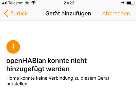

The trouble started when I tried to do the pairing in the iOS Home app.
  1. First of all I can detect my instance
  2. After entering the PIN pairing starts
  3. After a while pairing failed

I cannot find any helpful error message in the logs and I also saw this post. But I think the difference is, that I can find my openHAB instance and I can start the pairing process. This is why I think this is not a firewall issue to establish the connection. My device is also connected via LAN not via WIFI.
Does anybody have an idea how to trace the issue to fix it?

Finally I fixed it. I checked the documentation again and found this section:
openHAB HomeKit hub shows up when I manually scan for devices, but Home app reports “can’t connect to device”
If you see this error in the Home app, and don’t see any log messages, it could be because your IP address in the networkInterface setting is misconfigured. The openHAB HomeKit hub is advertised via mDNS. If you register an IP address that isn’t reachable from your phone (such as localhost , 0.0.0.0 , 127.0.0.1 , etc.), then Home will be unable to reach openHAB.
I am not sure since when this section is there, but after setting the IP in the field networkInterface pairing was successful. I am relatively sure that I have never filled this field in older installations with version 2.2.0 and still the pairing worked. However problem solved.
