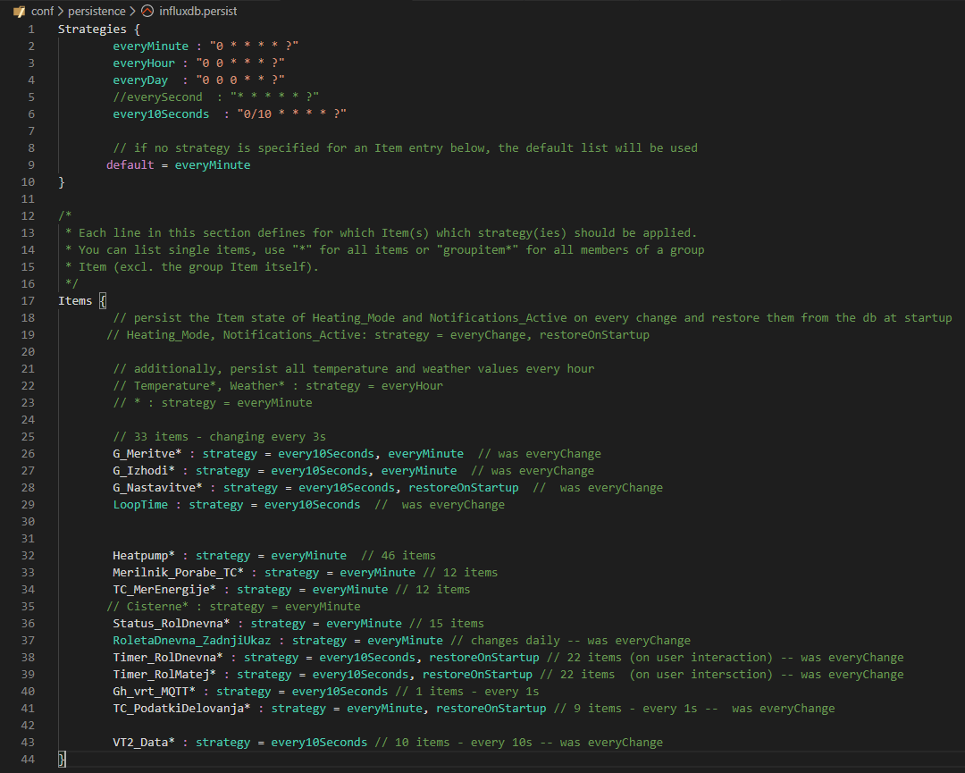

That is my influxdb.persist and it seems that OH is accepting it as Items have historic data.
I am mainly storing Numbers and a few strings.

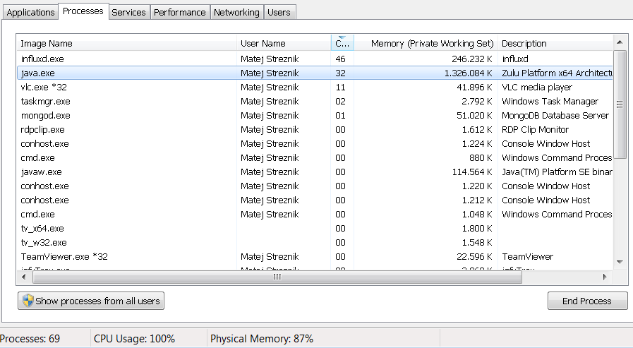

This is InfluxDB console on left and TaskManager on right, it might give you fealing of what is going on.
https://drive.google.com/file/d/14y6e8ib61LeiM1e3k5RwhwPLq77V8G8B/view?usp=sharing
InflluxDB stores accurate historic data and renders nice accurate graphs but how to get the CPU usage down.

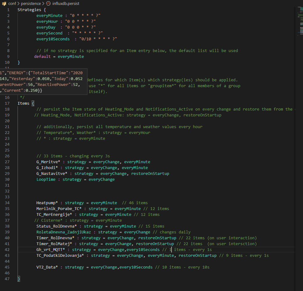

Have you tried removing every second from the strategies in influxdb.config to see if that helps?
You can put the InfluxDB add-on into debug or trace logging and verify your theory that it’s saving more frequently than configured to. Or you can query InfluxDB itself and look at what’s in there to determine if there is more than expected (i.e. OH is storing more than configured).
I’m skeptical that’s the cause of the problem and ultimately you will find the answer to your problem on an InfluxDB forum.

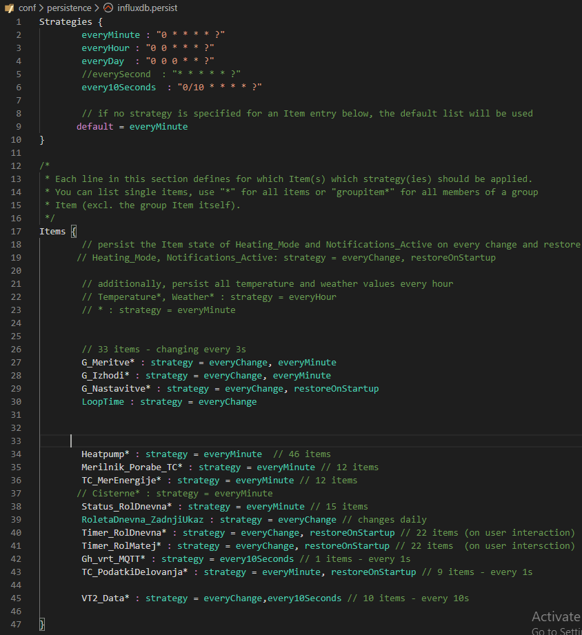

I have commented out everysecond and removed some everychange instructions that were triggering frequently, restarted OpenHab but sadly still high CPU usage, thanks anyways.
What are you storing here, about 150 Items every minute plus any changes? 200 states a minute?

Great suggestions, so…
That is my latest configuration, set to every10Seconds or everyMinute
Restarted OH. CPU drops to 2%, nice…
After OH started completely CPU is still on 100% and influx between 14 and 50%. If I observe SSD disk usage it is between 0 and 800 KB/s pulsing every 10s seems normal.
I know I expect a lot of performance from the “rocket in the pocket” device, but if it runs other things with 40% avg. load it should run DB as weal if polished.

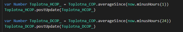

I’m asking about the continuous queries that you can set inside InfluxDB, typically in order to reduce resolution such as taking the average over the last hour and inserting it as a new measurement. But you also make the good point that if something like Grafana is refreshing frequently you’ll see a lot of traffic. All of this should show up in the InfluxDB logs if they can be found…
Aha, you mean averaging queries like this.
I have about 10 averageSince querries.
Yes graphing is somewhat tasking but it is unlikely that any web ui would be left open on any of our devices at given time.
InfluxDB has its own continuous queries which is what I meant, but I suspect you are not using them. Yes, the queries you list would use CPU, but enough to cause the high load that you see? Maybe the log file will show something.

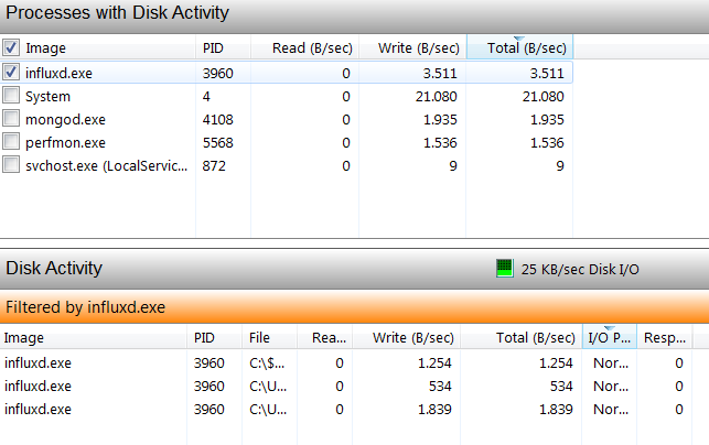

I found out that by default InfluxDB desn’t make log file.
The computer is a bit slow when I connect RemoteDesktop and it can’t open programs fast enough.

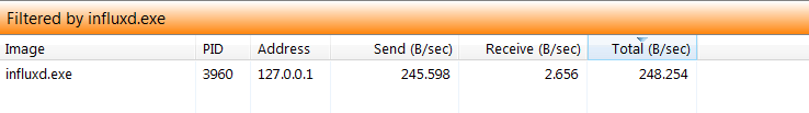

I’m certainly curious about the transaction rate, is that in there?
Network activity
Disk activity
It doesn’t seem a lot.
You may notice mongodb that UniFi Server application uses with about 10 - 25 writes per second and it uses only 1% cpu.
Matej
So your disc is getting written to 25kB/s … influx db accounting for “only” 3.5kB/s of that.
Seems like a fair traffic to me. What are you actually doing on this box? It’s not home automation.
Interesting, no reads. Should rule out Grafana contention.
