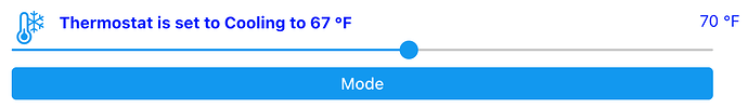

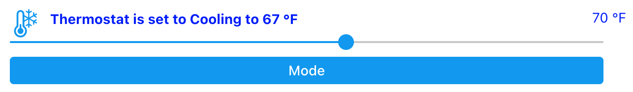

Not by default. There is a one-Item-one-widget by default. However, you can reference and represent as many Items as you want in a single widget. For example the following widget shows the current temperature, has a slider to change the thermostat setpoint, and a button that can change the HVAC mode between heating, cooling, and off.
