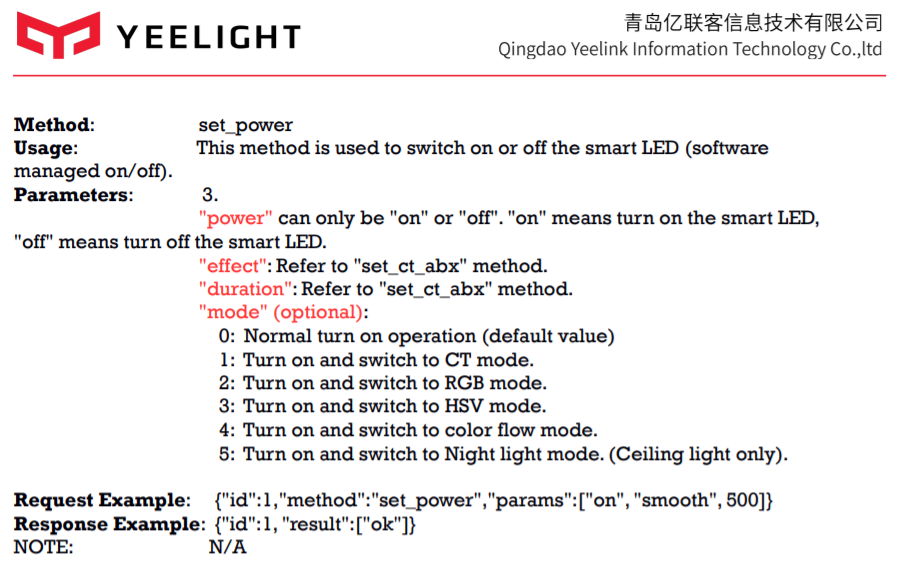

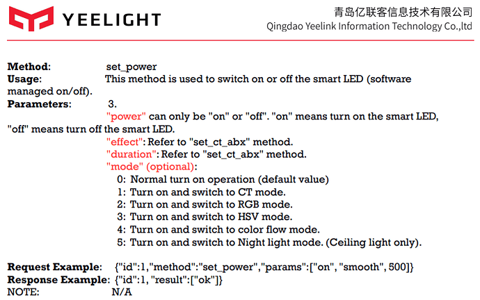

Hi @marcel_verpaalen
could you please have a look at the known issues section above? I just checked the sources and I see the following in the yeelink.light.ceiling4.json file:
							"value": "2",
							"label": "CT mode"
							"value": "1",
							"label": "RGB mode"
To be honest I don’t know the binding code well enough to know exactly what this file does but shouldn’t CT mode be set to 1 and RGB to 2? This is the way other lamps behave and what the binding documentation says as well.
Also Ambient Color Mode is configured like this:
				"property": "bg_lmode",
				"friendlyName": "Ambient Color Mode",
				"channel": "ambientColorMode",
				"channelType": "ambientColorMode",
				"type": "Number",
				"refresh": true,
				"actions": []
Shouldn’t there be any actions? In fact the color mode channel of the downlight has some actions but it does not support color light at all. Only the ambient lighting supports CT and RGB modes.
Again I don’t know exactly how the binding works but this seems to match my observations as described in the “Known Issues”. Thanks for your help!
I’ll double check.
I vaguely remember similar issue on other yeelights. Could also be the discrepancy/strangeness between the yeelight spec and the reality.
but also
Oh I see there’s room for interpretation in the specs :sweat_smile:
Please let me know if I can assist you in any way! Thanks!
