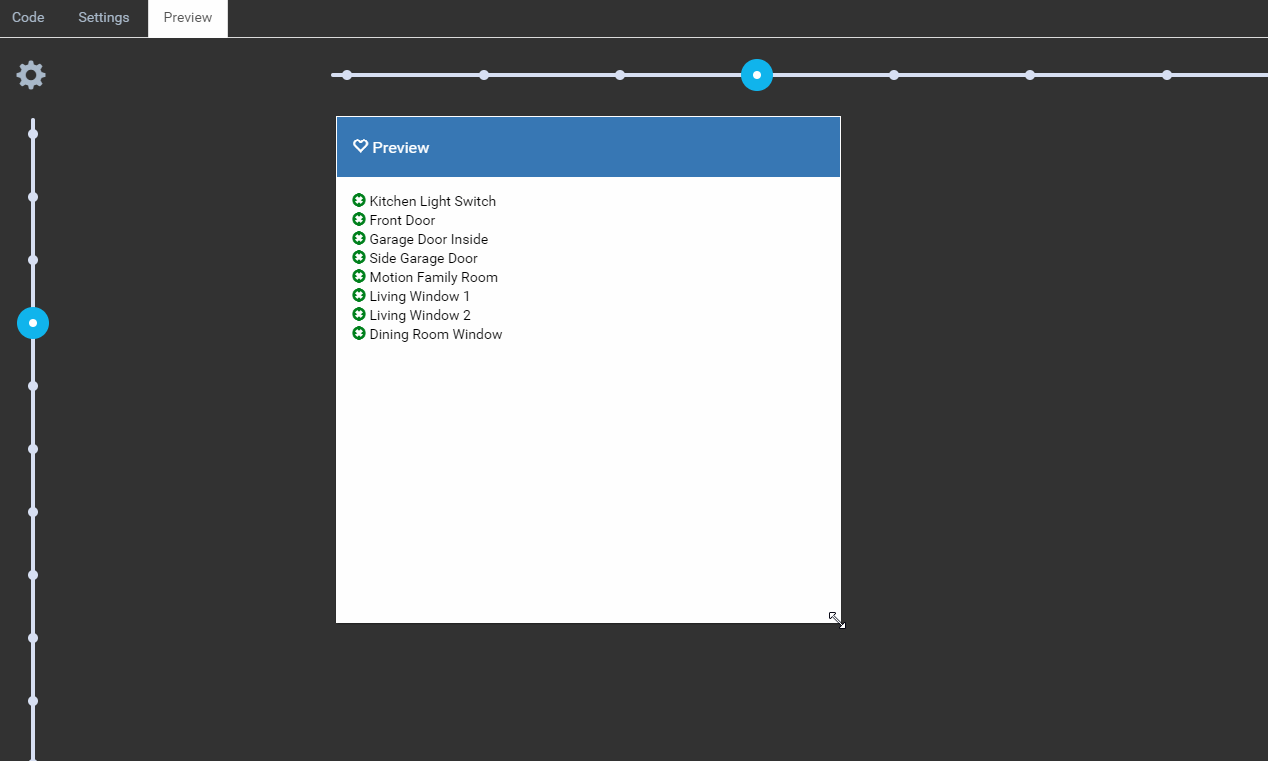

Demo
itemdashboard

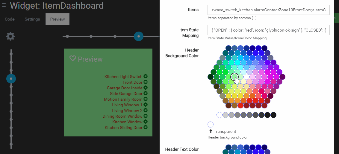

Configuration
Configuration is self-explanatory except for the mapping.

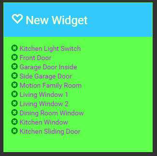

itemdashboard_responsive
State Map
The icon and color change based on the state of the item. The Icon and color are mapped according to the configuration you provided. If you do NOT provide a map, the icon and color will not be displayed, but the item label will remain.

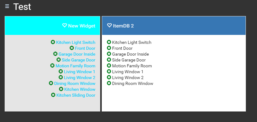

Multiple Widgets in a Page
The widget uses a unique id when creating styles, so you can have as many Item Dashboard Widgets and they will all have their own unique styles that you can set per widget.

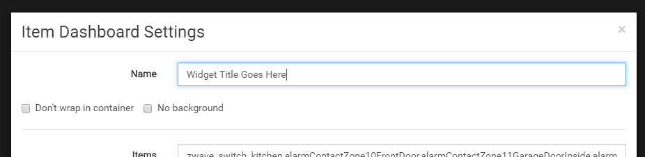

Widget Header Text
The widget header text is retrieved from the “Name” when you configure the widget
