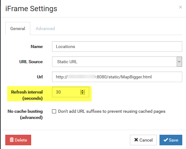

Unfortunately, the page is pretty much static and will not update when items update. You can however, set it up to refresh at an interval of your choosing. From your original question, it looks like you are wanting to get this in habpanel. You will want to use a frame widget, which has a setting for refresh interval.

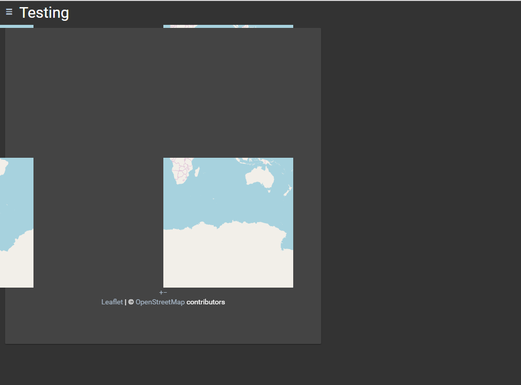

I get no error and something is being loaded, but it doesn’t look quite right, as you can see:
I’m probably doing something very basic very wrong, but I have no clue what and how to fix…
@mikaelgu you might be running into this:
(it’s not from ui-leaflet but the library it was forked from, so it still applies)
Basically the size of the widget is wrong because it’s computed before the gridster (dashboard grid) is completely drawn, so it’s confused. Does it fix itself if you resize the window? If so you might need to call invalidateSize() somehow.

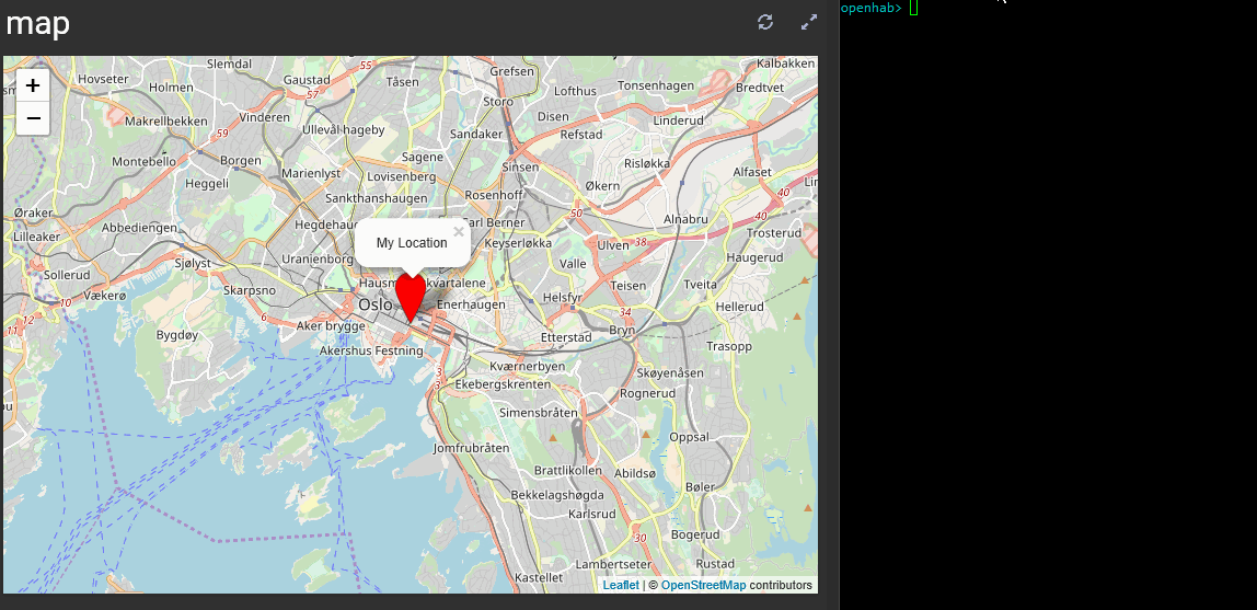

Yeah, I had a look and made it work after some struggle with the markers which would not show up, so I used the leaflet-vector-markers additional library as demonstrated here:
That way you could have different colors/icons for different markers.
So you need to download those files in conf/html

And the template (note the undocumented ocLazyLoad syntax to load the files sequentially):
<div oc-lazy-load="{ files: [
                       '/static/leaflet.css',
                       '/static/leaflet.js',
                       '/static/leaflet-vector-markers.css',
                       '/static/leaflet-vector-markers.min.js',
                       '/static/angular-simple-logger.min.js',
                       '/static/ui-leaflet.min.js',
                       '/static/map.controller.js'
                     serie: true
     style="position: absolute; left: 0; top: 0; width: 100%; height: 100%"
     data-snap-ignore="true">
  <div ng-controller="MapController"
       style="position: absolute; left: 0; top: 0; width: 100%; height: 100%">
    <leaflet center="center"
             markers="markers"
             defaults="defaults"
             style="position: absolute; left: 0; top: 0; width: 100%; height: 100%"></leaflet>
  </div>
</div>
Replace the DemoLocation hardcoded item by e.g. $scope.config.item if you’re making a custom widget (bonus points if you share it afterwards in the gallery!)
