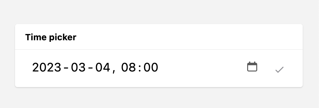

Should render something like this, but the input field might vary depending on your device/browser:
