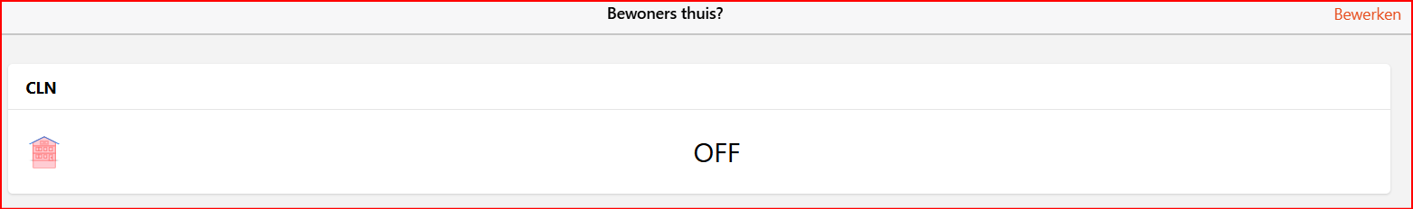

But unfortunately, that code looks like this:
I would like to only show the dynamic icon, and not the state string. Something like an oh-toggle-card, but with the icon where the toggle switch is.
