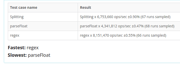

I wonder what’s going on with the split case. As I had guessed, a quick and dirty benchmark test shows that split is a little faster than parseFloat (although regex beats them both).

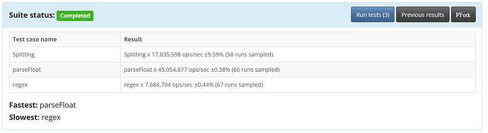

Maybe that’s because parseFloat is actually the fastest? You made a little mistake in the benchmark - Number.parseFloat() returns the number itself - you shouldn’t use [0] on it:
Nope, you are misinterpreting the results. The numbers given are the number of operations completed in the the time frame, so the higher number is the faster operation. It even specifically says parseFloat is the slowest and is half as fast as regex:

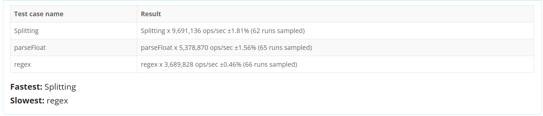

The results were definitive enough that I wasn’t worried about too many small facotrs like that. If we really want to be as accurate as possible then we would also want to .toString() the parseFloat value to emulate displaying that value as a string which is the intention half the time with widget expression anyway:
Interestingly, that significantly hampers the regex speed, but the other two remain mostly the same, so parseFloat is still slower then split:

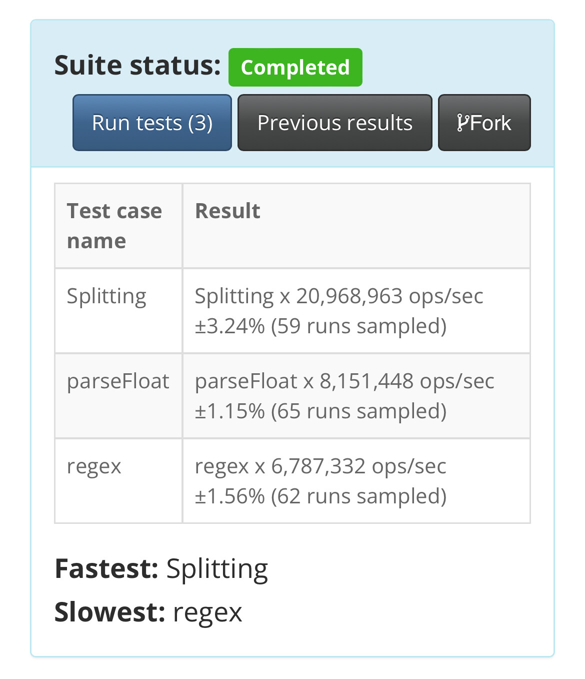

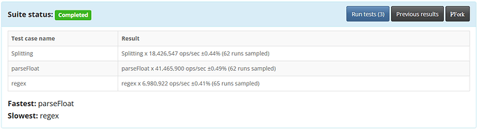

In the end, however, although this is all theoretically interesting, it is mostly moot. The widget exrpessions are NOT js they are a js-like expression parser so the speed of these operations has more to do with how they are implemented in the jse-eval library than raw js. If you say you see a performance boost with parseFloat in a widget, then that may be true.
Also, the reason I probably saw the improvement in the widget was because the only places which I changed where the comparisons and calculations with numbers - so where numbers where being compared etc
Interesting. I use Chrome so that makes the results consistent. I guess it’s not too surprising that the browser’s js engine has an impact (my 40+ chrome tabs, may play a role too ).
