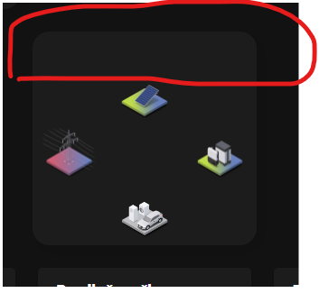

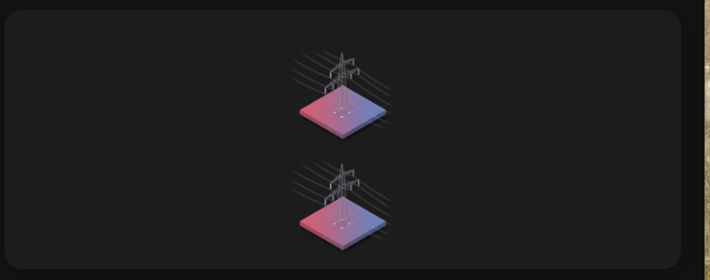

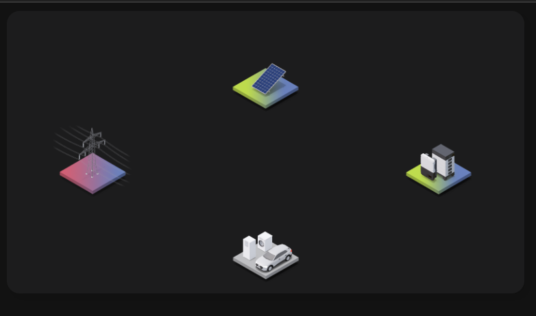

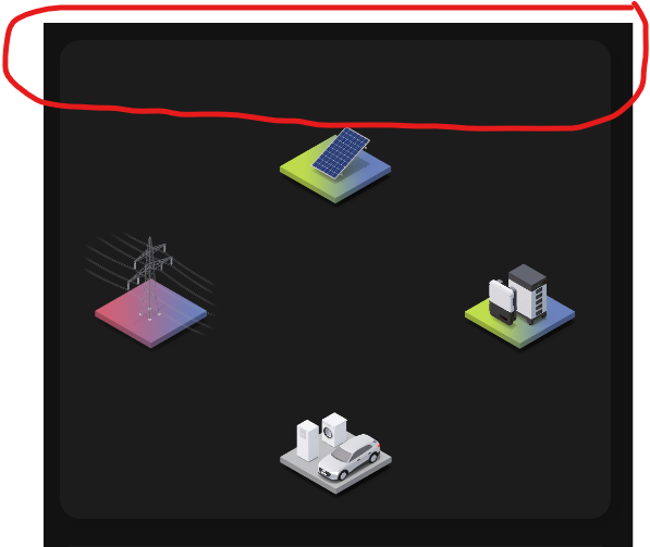

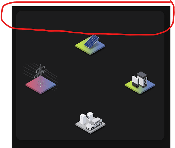

I created a page like this :

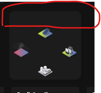

my problems is, that on the mobile phone it’s wrong displayed :
looks like a pictures aren’t resized but background windows is resized.
My idea is, that also background windows isn’t resized and widgets are shown below
How to configure ?
Use the column options as described in the docs to make your widget full size on a smaller screen
makes me crazy. I read a ten times and did a lot of tests, but widgets are still resizing and deformed. Don’t know what I’m doing wrong. :frowning:
Maybe best for me will be, when witget (or window under widget) will have still the same size.
Looks like that only background window is resizing but widget picture is still the same :
Maybe complete overview page definition is wrong or somethink in the widget is missing
It will be much easier for us to help you if you show us all the code you are using.

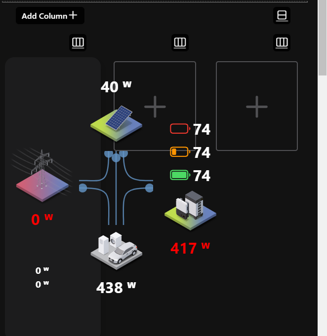

sure, no problem, which code. Of the overview page where widget is or widget code or both ?
Mostly the widget, but also the page if you’ve done anything unusual instead of just configuring it from the UI page builder.
No, I added a widget as usual (Ihope) via + on the overview page. But to be sure sending also page code:

Yep, page config looks fine.
This widget isn’t made to be responsive in size, so it’s working exactly as defined. If you look through the code, many of the pieces have width and/or height dimensions that are defined with pixel units (px). These are absolute values; they won’t change when the container they’re in or the screen they’re on changes size around them. If, on one screen, a 120px element is only 1/10th the screen, it’s still going to be 120px on a screen half as wide but that’s going to be 1/5th of the screen in that case.
The way to have a complex widget such as that effectively scale is to make sure that all the dimension properties are in some relative unit such as %. The first step of that conversion is very easy. You see that the initial card has a height defined in pixels (460px). Every other element in that widget can have a % height that you can easily calculate by dividing it’s absolute height by by 460. You could add an absolute width and then perform the same transformation on all the properties. Then to make sure that the height and width of the widget scales pretty well, you just have change the height and width of the initial card in any number of ways that suit your use. It’s gets much more complicated after that, unfortunately, with the padding, margins, and, in particular, text which is probably why the initial widget author didn’t make this widget responsive in size to begin with.

There’s no specific “widget resize” function. Changes or no changes in widget size are simply determined by how the widget’s css is defined.
The oh-icon widget has it’s own height and width properties, but these are restricted by the code to the absolute pixel sizes. If you want to use any other css width unit such as % then you have to put it under the style config which is a different method.

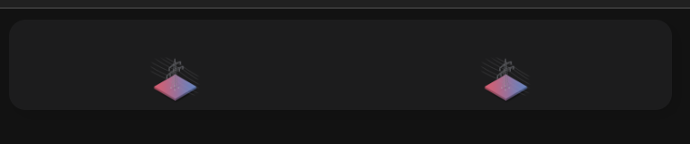

Idea was test icon resizing. It’s working, but…
I created a f7-card with f7-block and inside f7-row with 3x f7-col and once more again f7-row with 3x f7-col. Idea was that I will have a two rows with three columns, but I have one row with six columns.
I think problem is maybe how is used f7-block, but not sure.
As source I used this :
Don’t set the f7-block to display: flex leave it at its default value (which will be display: block). Flex display means that the block will try to fit it children (the rows) all on the same line and only move one to the next line if there isn’t enough room. Block display will always stack it’s direct children.

But I created matrix 3x3

and strange is that result isn’t a square :
edit:
change icon width to 80% improve situation, row is now bigger, but strange is big gap up:
and resized is gap bigger:

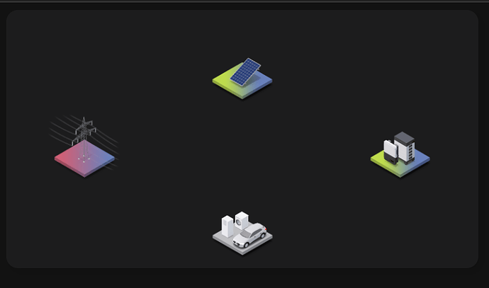

Now you’re getting into not just the size of elements but the spacing and placement. The result you see ins’t square because there’s no directive at the moment to tell it t be square. The columns that you have in side each of the rows are being spaced apart by the row’s display: flex setting. One of the best resources for learning about what is going on with flex spacing is:
Thanks, very good guide. But what isn’t clear for me is, that I have a 3x f7-row, flex display and center alignment. So from my understanding space up and down must be same, but it isn’t:
Doesn’t matter that it’s not a square, it’s clear for me why.
You’re browser’s inspect function is a great help in debugging things like this. It will show you which element is responsible for that space and in turn you can trace that back to your widget code. Often times you’ll find it’s just a issue with one margin or padding property.
If you want help finding that particular issue, you’ll have to post the current state of the code. It’s impossible to guess just from the picture as there could be any one of a thousand explanations.
