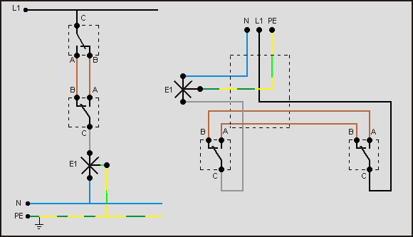

Could you please explain a bit more what you mean with multiple deviators controling your lamps.
Wiring diagramm e.g. ?
I have several lamps in my corridors which are controlled by 2 switsches each. In that case my Shelly device will be placed at the switch which has direct connection to the lamp. Switching in Shelly can be configured to be an edge switch, something like a toggle. So lamp is controllable by openHAB an still the two physical switches.

@hmerk: here is a wiring diagram1 of the current state for reference:
I was thinking to use another relay placed in parallel as if it were a third deviator like the ones in the diagram so it would simply work like this diagram2 [sorry, I am allowed to post only one picture, I will link this one]: http://www.elektro.it/impianto_appartamento/impianto_appartamento_img/impianti_civili_15.gif

Just a quick answer from my phone. It looks basically like my wiring, so no need for additional effort, just one shelly needed. I will have a closer look and try to add the shelly wiring to your diagramm.
@hmerk: awesome! Thank you so much :slight_smile:
One further question, do you have a hot wire (L) near the nearest switch to the lamps? Cause this is mandatory for the shelly to work. In my case, I can place them behind a switch combination where „single“ switches are in place es well. So I have hot and switched wires (L) in my wall boxes.
I am not sure yet (house is WIP), I guess not in every box. However, they put large corrugated pipes (if that’s what they are called in English) so it sould be fine to fit another wire in there!
Ok now, I have my first Shelly-1 in place, controlled via openHAB and two physical switches.
Wiring:
In Shelly settings (original firmware) configure your switches to EDGE switch (last option),
Works as expected and state in openHAB reflects real lamp state, no matter if one of the switches was used or openHAB.
