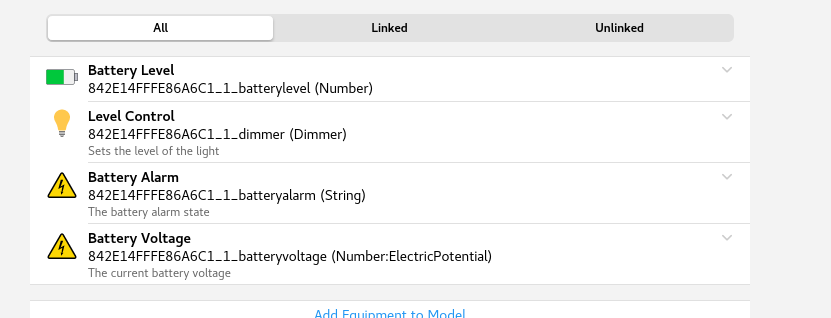

The device is found via the Zigbee binding and looks like that in the PaperUI:
Is that the expected appearance for this motion sensor?

My device:

ich habe the same device and the same channels.
The problem ist still the same. I can pair it and it goes online and sends the battery percentage and volts but no motion channel is found.

I have very little information, so can’t really comment. From what I see above, this device provides a dimmer channel, so I guess this is what is sent when motion is detected. The dimmer can be a level control setting (I’ve no idea how this would work for motion) or a switch, and from the above comments it seems that this is what is sent when motion is detected?
That’s a guess though since I don’t have this device to test with.
Thanks for the fast reply.
I tried to connect a dimmer, string and switch item with the level control channel (dimmer channel) and all items stay NULL. The other channels (battery level and volt) work fine.
Thr level control ist the only channel avaliable that may respond to motion but it doesn’t.
