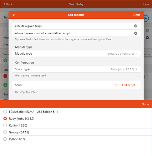

Meanwhile, I’m experimenting with the script editor in the UI in the 3 supported languages :slight_smile:
I think it could be an alternative to write your rules in in the personal folder for simple stuff, and still be able to import the library code.
The Python libraries load pretty well but I get ClassNotFoundExceptions when loading most files from the JavaScript libraries. Still, fascinating stuff, being able to use 3 programming languages at will, even in the same rule!
Beautiful! My crystal ball says 50% of users will use straight UI rules, 30% will use Scripted Conditions and Actions (the audience for the features you’ve added… and this number will grow when there is an ExtensionService for templates, etc.), and the remaining 20 will just use scripted automation through files.
BTW, there are not just three supported languages. With openhab-core/#635, all installed script engines will appear in the ‘Script Type’ dropdown for Scripted Conditions and Actions. I have only tested with the three you have been using.

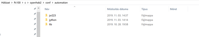

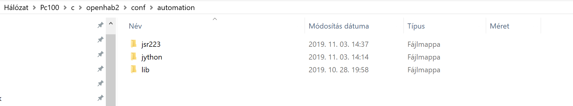

Are you s sure you copied the Helper Libraries to the right folder? The contents if the Core folder (automation on down) needs to be copied to $OH_CONF. You don’t copy the whole helper library over.
Here is my automation library:
only /core/ folder copied. Path: c:/openhab2/conf/automation it is on windows10.

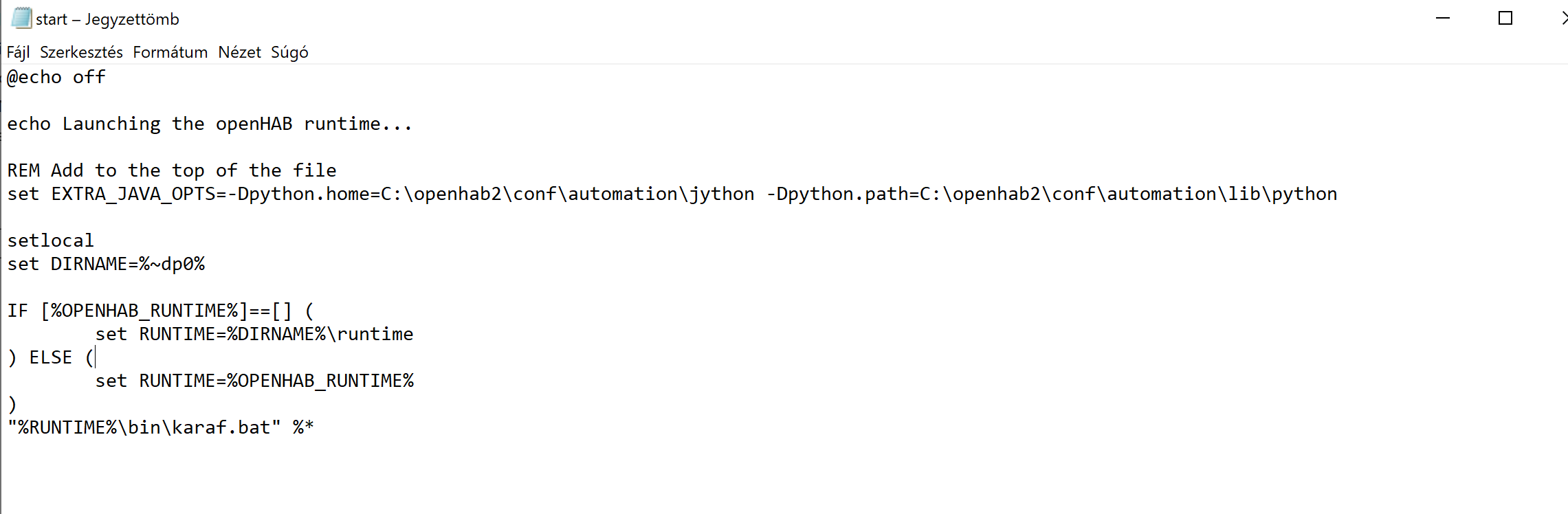

Have you restarted OH? People have reported this error when Jython is not installed correctly. Did you modify EXTRA_JAVA_OPTS with the python.home and python.path? You still need these even if you bypass the bootclasspath by putting the Jython jar in /runtime/bin/boot.
This is my startup.bat file:
I have added the same to sh.bat as my Openhab runs as a service.
I can add as an windows enviroment variable instead.
