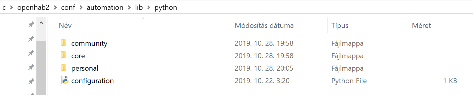

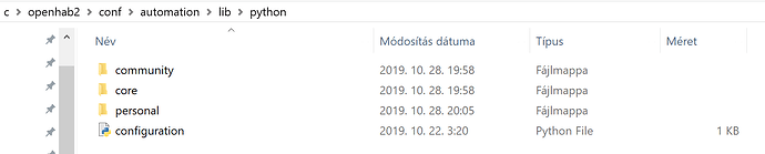

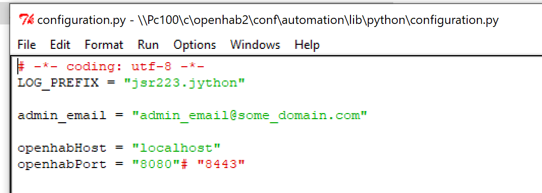

I just looked at your log and Jython is starting. What do you have under C:\openhab2\conf\automation\lib\python? Did you setup your configuration.py?
Here is the path and the content:
That looks good. I think it has something to do with your EXTRA_JAVA_OPTS or permissions. What happens if you start OH manually?

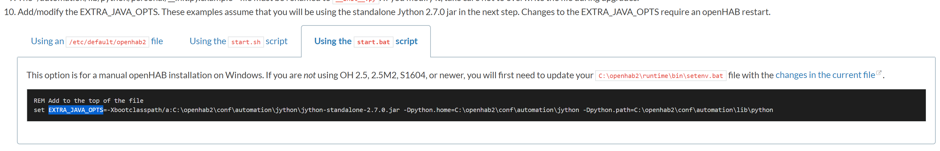

So I have installed 2.5R1. Than I set up according to helper instructions. I have checked setnev.bat and config is ok so I suppose to use this in start.bat: 1. set EXTRA_JAVA_OPTS=-Xbootclasspath/a:C:\openhab2\conf\automation\jython\jython-standalone-2.7.0.jar -Dpython.home=C:\openhab2\conf\automation\jython -Dpython.path=C:\openhab2\conf\automation\lib\python
however it does not work, so I used this workaround: [Windows] All OH logs stop when Jython is in the classpath - #21 by ysc

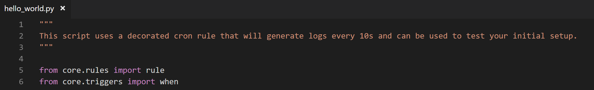

but than when any Phyton or Jythone rules are starting none of the libraries are loaded. I get such error messages: Error during evaluation of script ‘file:/C:/openHAB2/conf/automation/jsr223/python/personal/hello_world.py’: ImportError: No module named core in at line number 5
line 5:
Put this in a script and post the result…
import sys
from org.slf4j import Logger, LoggerFactory
LOG = LoggerFactory.getLogger("jsr223.jython.TEST")
LOG.warn("sys.path = {}".format(sys.path))

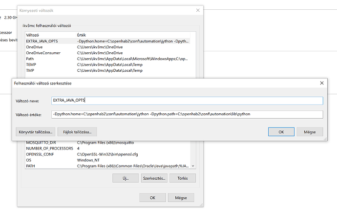

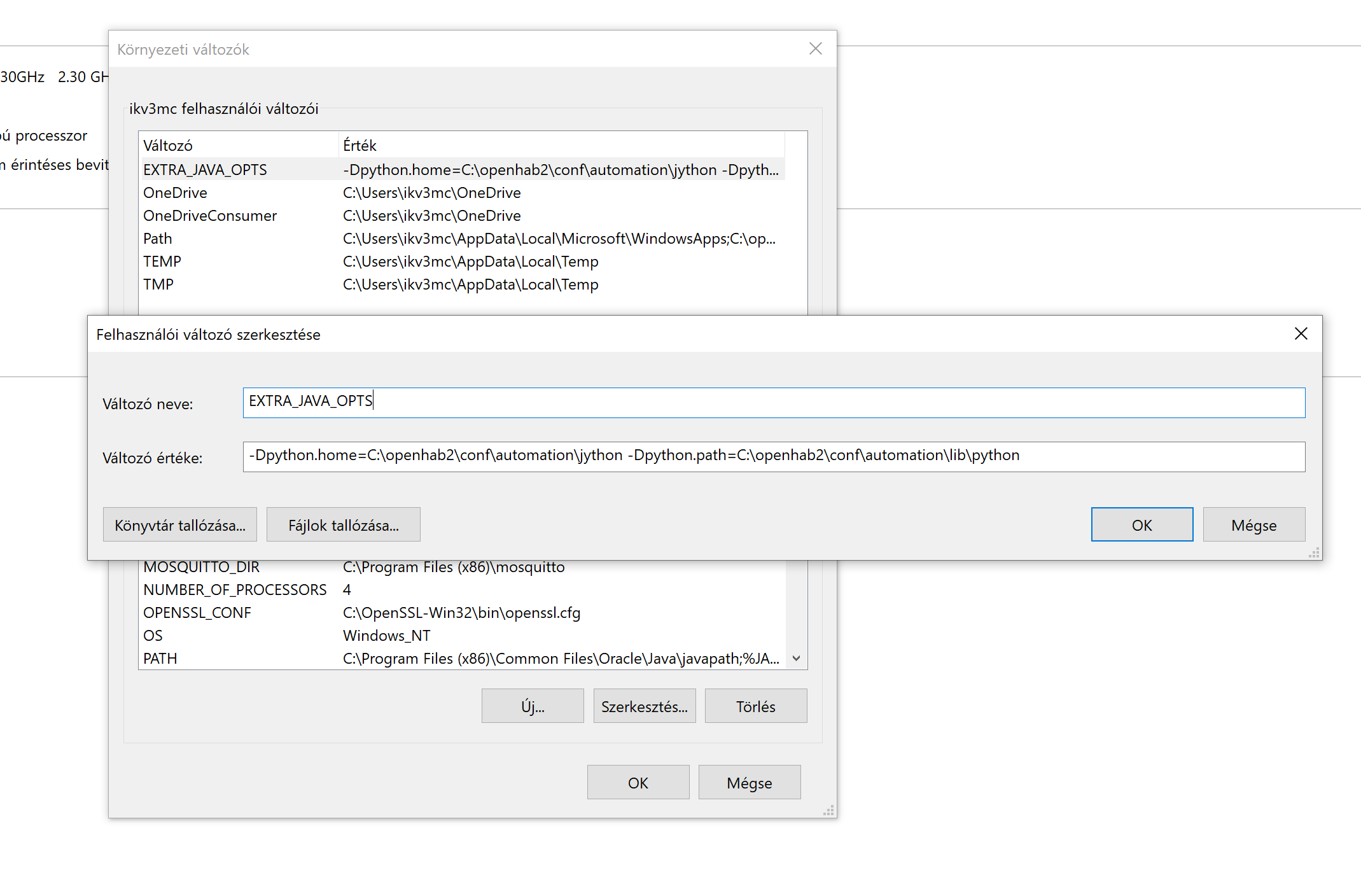

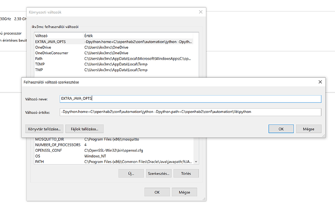

I forget… is that top section user or system? Set it in the system variables so that your service can use them. Or set the runAs for the service as an actual account, then log in as that user and set their user variables. Much easier to do this in the start.bat. And even easier to use the bundle!
Openhab runs as a service on my server.
Same result: 2019-12-21 20:21:56.358 [WARN ] [jsr223.jython.TEST ] - sys.path = [‘C:\openhab2\runtime\lib\boot\Lib’, ‘C:\openhab2\runtime\lib\boot\jython-standalone-2.7.0.jar\Lib’, ‘classpath’, ‘pyclasspath/’]

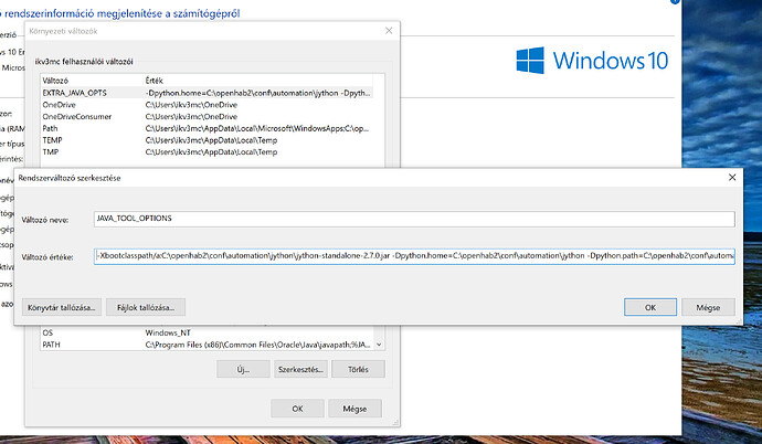

Here is the enviroment variable what I use now:

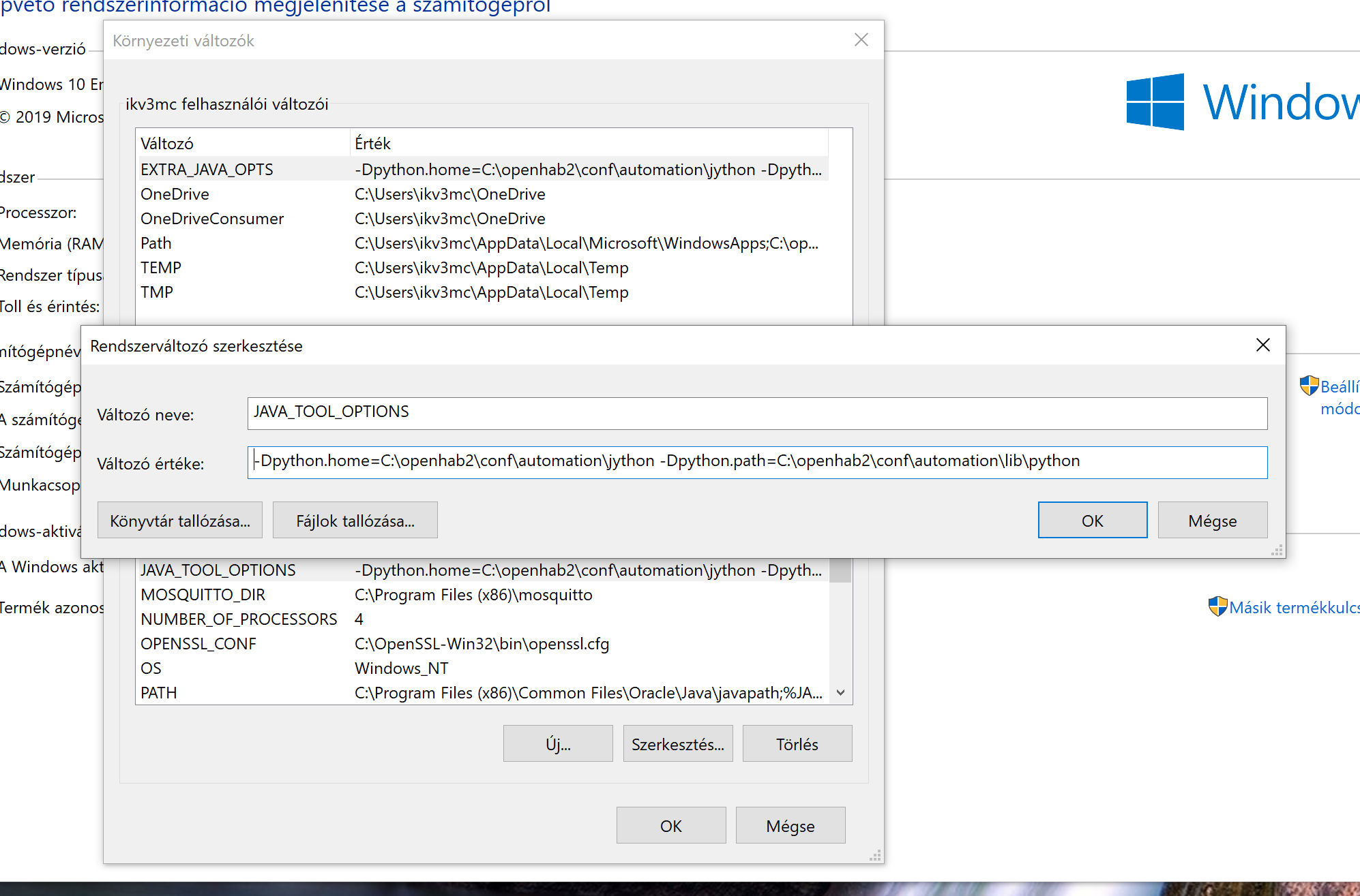

I would think that the solution is very simple. I set everything back (deleted jython standalone from lib/boot folder, deleted all extra_java_opts lines from start.bat, setnev.bat etc) to default and I have changed only one thing:
I put into enviroment variable JAVA_TOOL_OPTIONS instead of EXTRA_JAVA_OPTS and it works immediatelly.
so in case of windows I would change description of installation here: Installation — openHAB Helper Libraries documentation
Also there is one thing what is not 100% clear for me. Whitch start.bat we have to modify? There is one in main openhab2 folder and another one in \openhab2\runtime\bin folder. It should be also specified.
