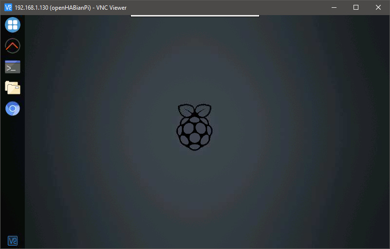

the desktop. i might change the icon theme in the future and add some appropriate apps to the launcher but for now it’s functional

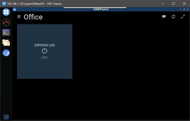

clicking on the openHAB icon goes straight to this page, full screen and all. not much here at the moment but im working on it

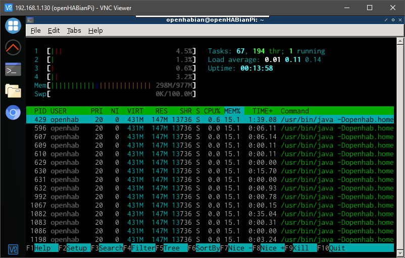

heres memory usage with the HABpanel running in chromium. openbox + tint2 are so lightweight i cant even notice they’re there. chromium is mostly whats hogging the memory

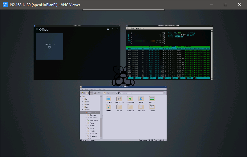

and heres my pride and joy… or should i say the most frustrating, time consuming, piece of beauty of this GUI. Skippy XD. i need a touch friendly way of seeing what windows are open and an easy way of closing them, but without cluttering up the application launcher. pressing the top left icon brings this view up and long pressing on a window will close it. this took me forever to find and install as its not in the repositories.
