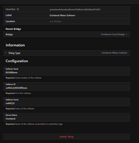

Getting thing information from: https://prod-eu-gruenbeck-api.azurewebsites.net/api/devices/softliQ.D/BS5000xxxx Where BS5000xxxx is the softnerid x’es is replaced digits

With the link SMadsen provided you can retrieve the data in a browserwindow however when adding the information to the binding it is not working
