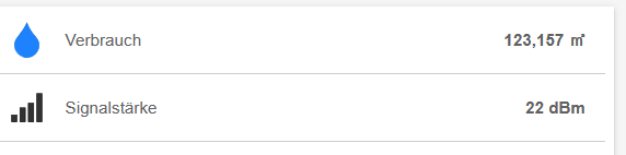

I can confirm the same my data is also not encrypted (Germany)…even my smoke detectors have m bus functionality and they are also not encrypted…but the same thing is you don’t know who is who besides your own because you can test by pressing the test button or look at the numbers…
But honestly it’s easier to find out if someone is on vacation with the simple stone trick…(Put a stone in front of the door if it’s moved someone was in)
Signal strength is transmitted too, so easy to find out the right home …

Using the ordered SDR stick it was possible to read the meter value once. I don’t know what happened here… I permanently I’ve got “mac error” .. I suppose something wasn’t perfect during receiving the transmission even there are only 1.5 meter max in between.
I ordered the IMST iU891A stick and this was running directly without any issue.
I installed the wmbusmeters locally, also mosquitto_pub and can see all data within the broker.
Note: The broker is within a Docker container. I’m able to run the pub command manually but it wasn’t able from wmmeters service directly… Therefore I installed the MQTT client outside Docker, too.
