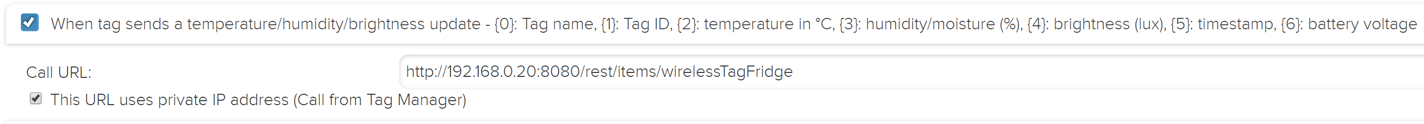

I’ve logged into the wireless tag manager at my.wirelesstag.net and set it up like this:

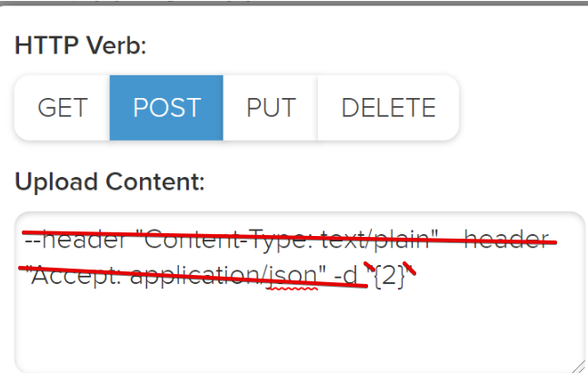

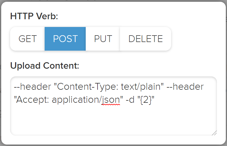

With the further HTTP option set to:
No joy though. I must be missing something. I can’t see any errors in openhab.log.

I don’t know the WirelessTags, but according to their Website you might only need to send {2} as data.
(source: Wireless Tag - Android/Web Interface User Manual)
That doesn’t seem to work either.
