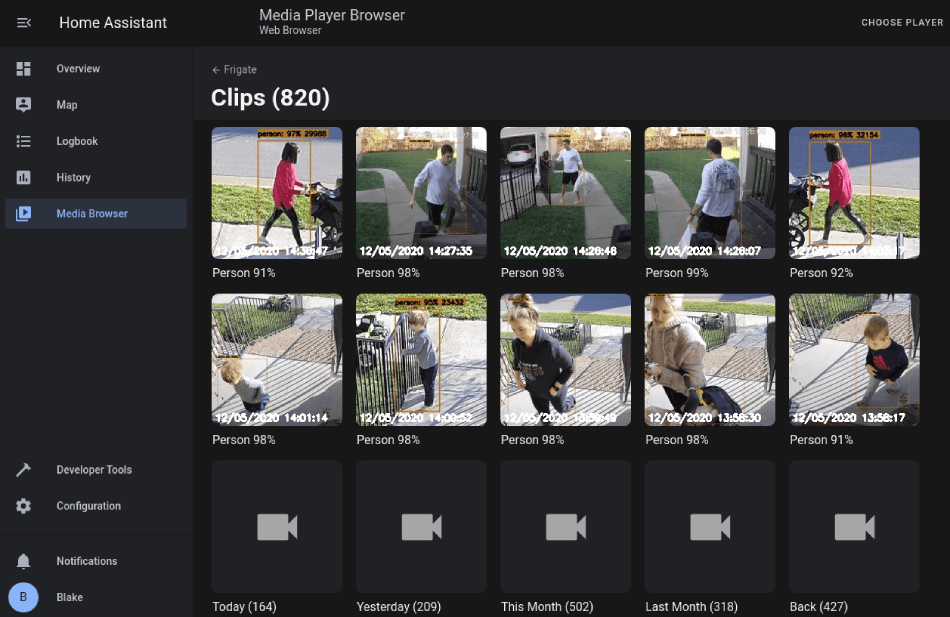

Wish there was OpenHab integration for Frigate too
Love how they integrated it into HomeAssistant… OpenHab deserves something like this too.

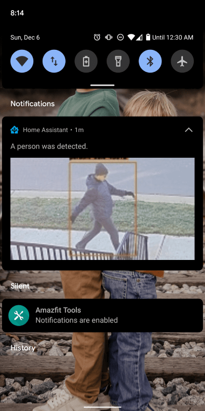

Telegram can be used to send full mp4 videos with audio to your mobile phone like your second picture shows.
Pushover can send animated GIFs that move that display on your phones screen without needing to be unlocked.
With either Telegram or pushover you then get a full event history that is not stored on your local network. I see this as a plus as if someone steals your electronics they don’t steal the NVR with all the footage.

What I would love to see in this case, is a nice add-on that simply just integrates into Frigate and gives that same ‘smart’ feature list of notifications on person-detection etc that the HA integration provides. Personally I would be running Frigate on a dedicated VM via KVM so no issue there.
I guess from an angle we could consider it a plug-and-play integration of the Frigate NVR into OpenHab, just like in HA.
These days, more and more people think of integrating their security cameras at home/businesses into their smart infrastructure. Frigate does all the work in that department in this case as far as NVR requirements are concerned, but a binding/addon to integrate Frigate into OH would be a superb addition to OH’s already expansive arsenel, not to mention another marketting pitch keeping up with latest developments. For example I was just the other day looking into purchasing some coral accelerators for myself to play with, that’s how I stumbled upon Frigate.
I’ve put some time aside to install Frigate and tinker with its MQTT integration. One thing I’d actually love is for notifications coming through like ‘Your toddler was seen going out of your gate’… that level of ‘smart’ is what really engages me, however as with all things ‘smart-home’, AI is somewhat still a very young ‘tinkering’ adventure and nothing truly plug-and-play is out there… but that I really believe is the future of ‘smart’ platforms… not just a bunch of sensors and rules… like going from manually controlled remote-control toycar to a self-driving car… leaps are taking place all across the industry, just not in the ‘smart-home’ arena just yet outside of a few very technical individuals with highly bespoke systems.
