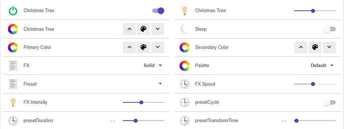

WLed: A binding for controlling LED strips and strings from an opensource esp8266 project
  1. How do I use segments?
  2. When changing presetDuration:

  1. Preset. The list does not open in basicUI. In the settings WLED Interface I added preset16 after creating the files of things and items. Maybe this is the reason?
See readme here
It needs to be a build made in the last 10 days.
Also check your sitemap against the example in the readme.
Yes! This is a different file than what I was looking at.
There are differences, tomorrow I’ll try and report back.
Thanks!
Some changes were made to get the binding merged and that newer readme will go live when V3 stable is released in a months time.
I couldn’t figure out how to manage segments :frowning:
Did I understand correctly that you need to create as many things as there are segments?
Thing wled:wled:stairs_seg0 "seg-01" @ "box" [address="http://192.168.215.29:80", segmentIndex=0]
Thing wled:wled:stairs_seg1 "seg-02" @ "box" [address="http://192.168.215.29:80", segmentIndex=1]
Thing wled:wled:stairs_seg2 "seg-03" @ "box" [address="http://192.168.215.29:80", segmentIndex=2]
Thing wled:wled:stairs_seg3 "seg-04" @ "box" [address="http://192.168.215.29:80", segmentIndex=3]
Thing wled:wled:stairs_seg4 "seg-05" @ "box" [address="http://192.168.215.29:80", segmentIndex=4]
I split into segments in the WLED interface and saved in slot 16.
In BASICUI, no matter what segment I switch, all the segments are switched.
Unfortunately I don’t understand how it works :frowning:
Yes, as each segment can have a different FX loaded you need a new set of controls for each. Some tips are:
  1. Don’t create segments that overlap, make sure each start and end LED is not overlapping or you get conflicts and it does not work very well.
  2. Some of the controls do nothing or may cause issues as the firmware does not support segments and cycling through FX for example, so those controls should not be linked.
  3. Expect some bugs in the firmware for segments and also expect some big changes in the next firmware of WLED for segments as I believe they are doing a lot of work in that area. I had it working pretty well here, but then after a few minutes of nothing being touched I got glitches and it changing randomly to a new colour.
  4. You need to use the most up to date firmware.
  5. I am not tech support, you need to work it out by playing around with it.
