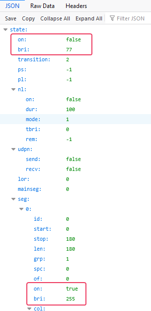

Which channel is used as a switch Item for power?
In OpenHAB I am able to use the segmentBrightness or the mastercontrols .
But both don’t seem to be synced with the devices power.
When I change the power in the WLED UI or in the WLED app the openhab switch is not toggled.
As well as I change the Power in openhab to OFF and then i am not able to toggle the power in the UI or app. It is shown as ON but the LEDs are still dark.
Please read my post here and the one just above that one on Global controls.
WLed: A binding for controlling LED strips and strings from an opensource esp8266 project - Add-ons / Bindings - openHAB Community
There is a partial fix (just doing another bug fix now) in the latest RC1 build just released if your using milestones do an update, or wait a few days for the newer 3.2 stable to be released. If you use the SLEEP nightmode timer feature it will change the global OFF and this fixes that but only for the masterControls channel which is the one you should use the most and also use this one for Google/Alexa controlling.
@eric1905 I just updated the marketplace jar to fix all known issues and a PR with the extra bug fix has been made and is waiting for review.
Hopefully this picture helps
Ok I got it. Thank you for your explanation.
