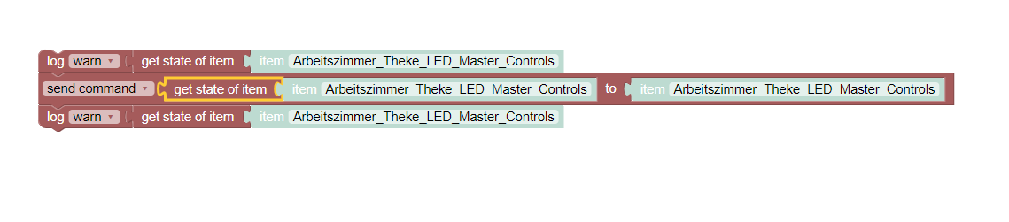

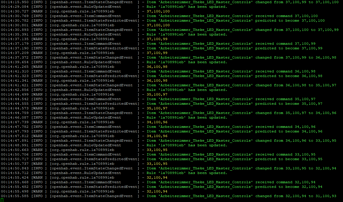

i noticed a strange “drift” behavior whe using master controls. In a Rule I read the current Value of the master controls item and send them right back to the item. The segment brightness and hue slowly degrade each time the rule is executed. I think it has to do with the HSB conversion. But since it’s a core lib i think it will be hard to come by. You can also reproduce this by sliding the hue Slider up and down a couple of times.
Rule:
Log:
