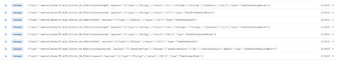

I monitored the item changes using postman via the /rest/events api. If I select a different effect in Basic UI I get the following item updates:
In this case I selected the item with the id 26. The item is updated to 26, but shorty after it is set back to the previous value. (in this case 1)
