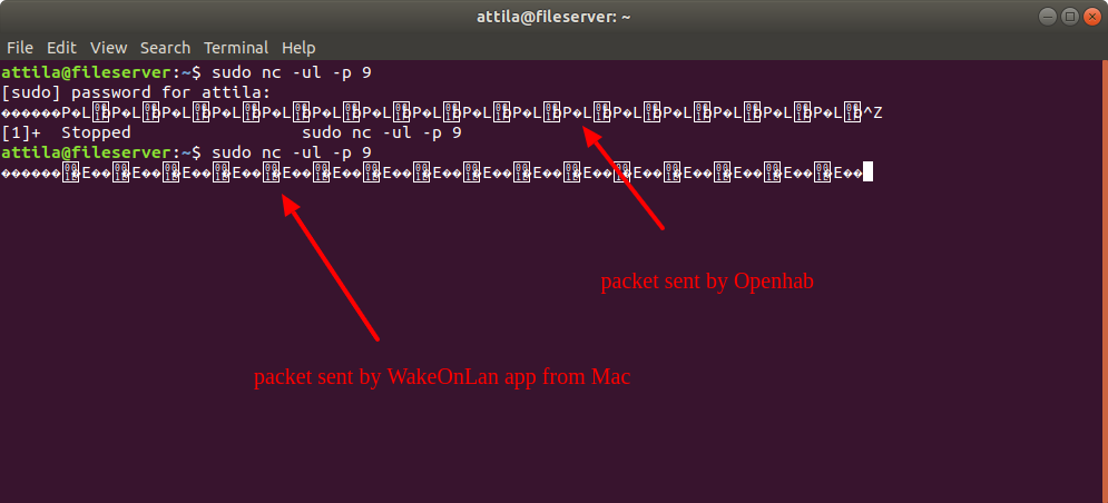

Since that I can’t make WOL work. WOL package arrives (please see the attached image), but it doesn’t wake up th computer.
The strange thing is that if I send a magic packet from my Mac via WakeOnLan application that wakes up the media server.
Do you have any idea what could be the difference between two magic packet? How could I debug Openhab WOL package?
