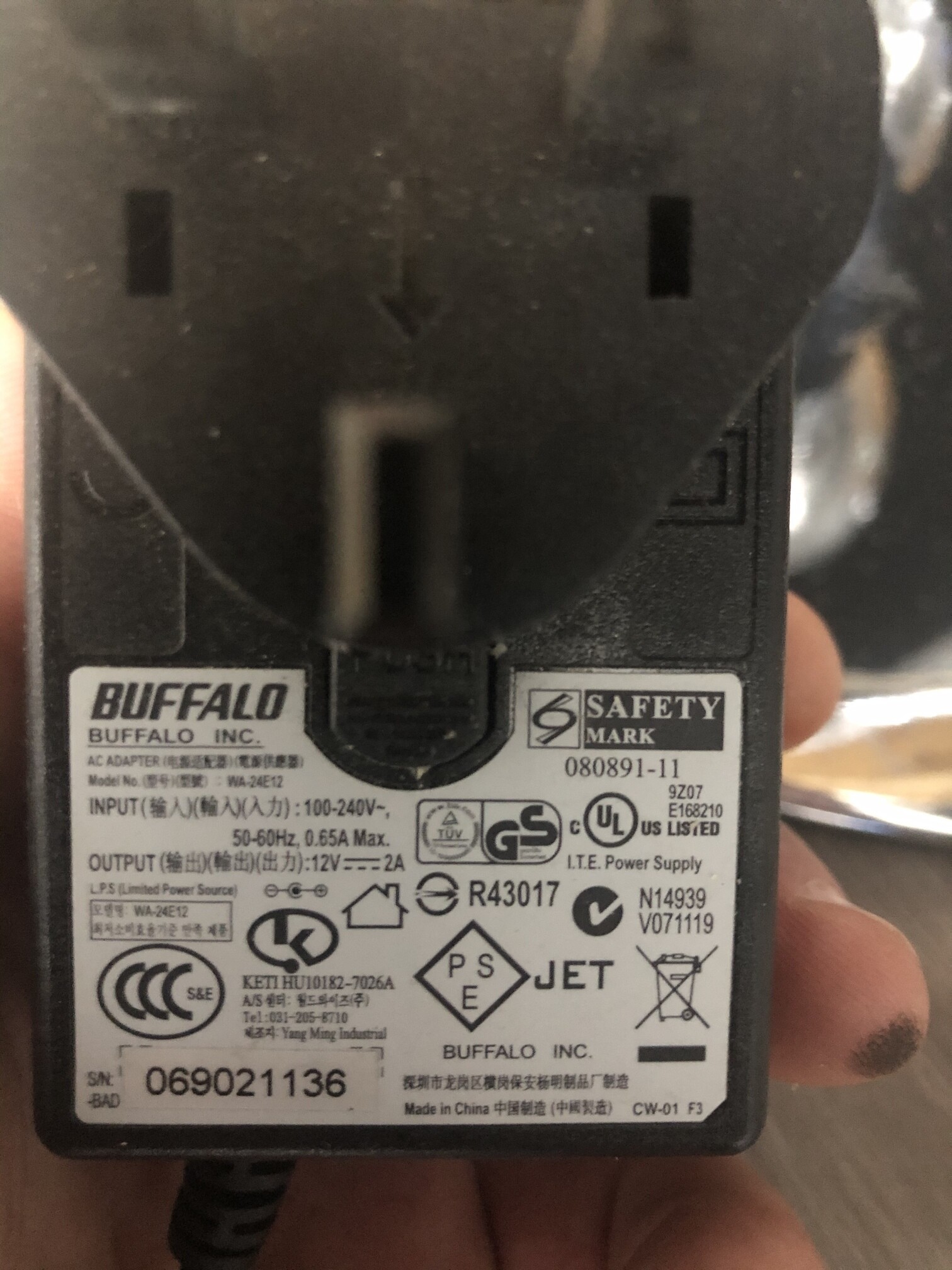

Lol I just checked the specs and indeed it does say AC.. I can confirm though that it works flawlessly on DC, and it doesn’t get hot like people have reported on various forums. I just assumed and don’t read properly that this would be a DC device. Very strange.
So right now I’m using an old 12v external hdd transformer and haven’t had any problems.
In regards the the 9v battery, it all depends on how active the doorbell is, I’m pretty sure I had it running for a couple of weeks before I swapped it over to the transformer
