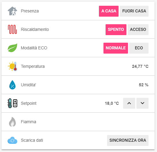

Monday update…
Here you have my progress:
In the rule if any related item changes I pass the full command to Nest server by the above script properly modified. There is about 2 to 6 seconds for the command to be executed on the cloud.
It’s fully working but needs some adjustment, ane is to implement a kind of timer to waits until all the commands are set to OH, for example if you neet to increase temperature from 18.0 to 19.0 and you tap un the up/down icons each tap send the command, in this situation you sent it two times (18.5 and then 19.0).
Only one observation, I think it’s better to avoid polling Nest server too frequently, because of this unofficial method we’ve not to abuse of it in order to avoid any changes from Google side to “block” the method. For example in the rule I “read” cloud data once each 30 minutes. At the and we don’t have to use nest data in real time… if you need to log house temperature is better to use any local device instead of your thermostat.

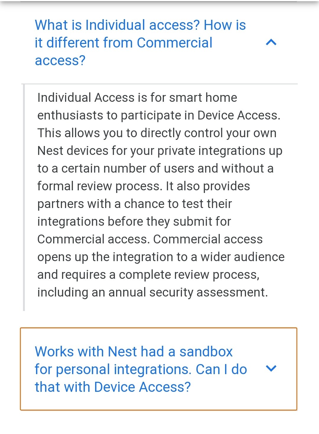

Just got a message from Google nest that their new “Device access console” is now available.
It also seems like they open it up for personal use:
Looks promising, doesn’t it?
Yes promising indeed. I also got the mail and still have my Nest devices :wink:
See also:
There’s also an API that allows for receiving events using Google Pub/Sub. Managing access to the traits looks very similar to how the permissions were managed in the Works with Nest API.
If I look at the terms I think it it possible for openHAB to register as a “Commercial Developer” (5 USD entry fee) and provide access through myopenhab.org, similar to how Google Assistant integration works now. Alternative way would be that each user registers individually.
Is the registration as organisation something the “openHAB Foundation e.V.” could be used for, even being a not-for-profit organisation (@Kai)?
