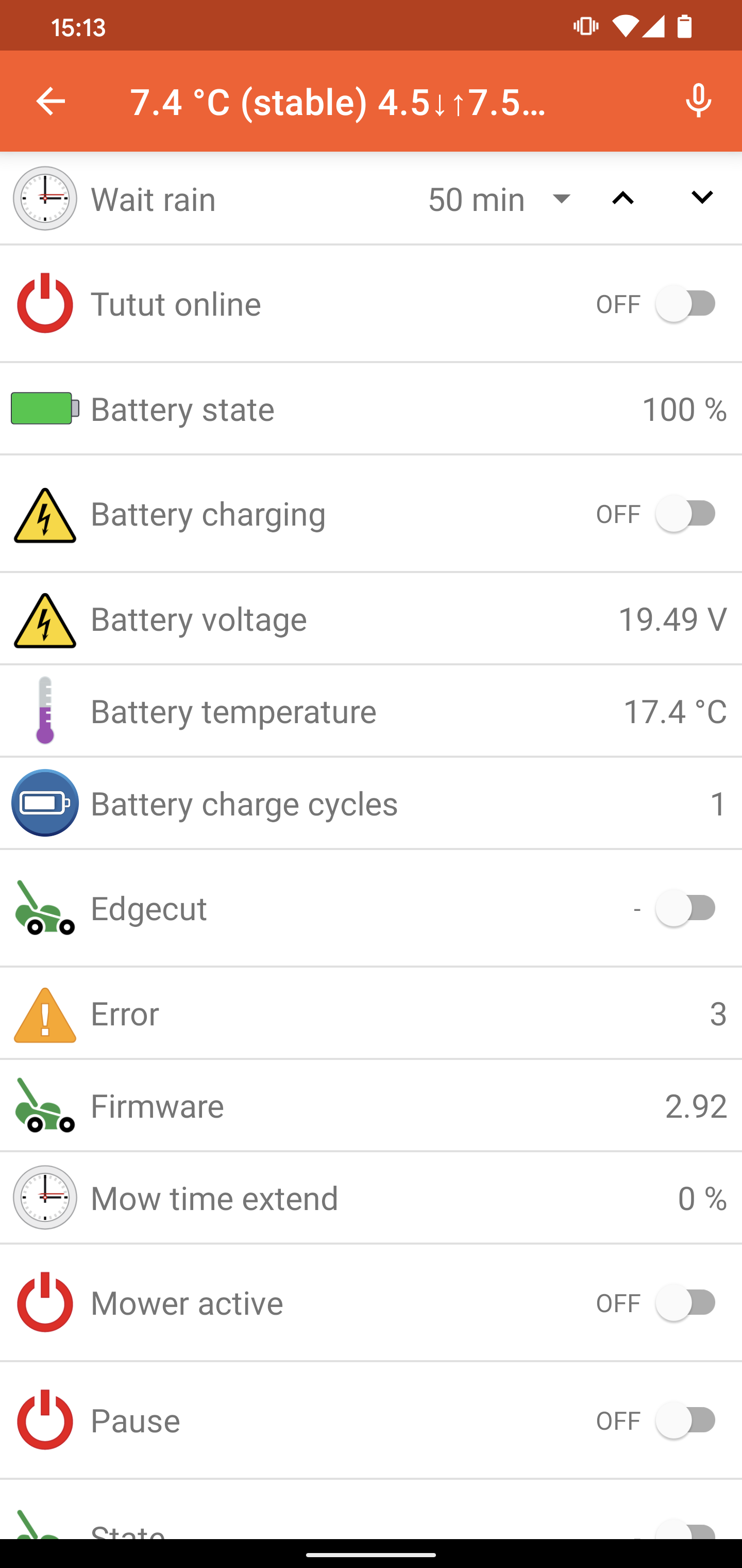

Sorry for not being clear enough. There is a working solution in iobroker that reads the worx API (including my new WR142E). You’ll only need to install e.g. the MQTT-client and the Worx adapters:
This data can then be retransmitted by e.g. MQTT, and you can then use it in Openhab. This is what I’m doing (I’m only testing with the Landroid in my living-room at the moment):
