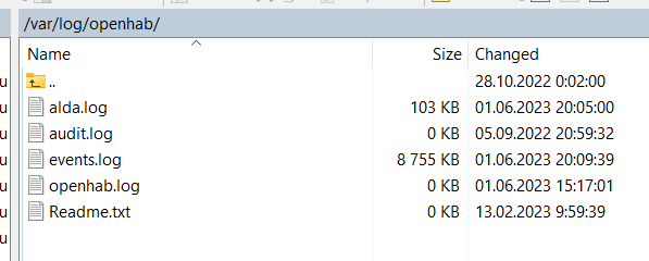

log to alda.log started yesterday evening, without any power lost, but data are not there in openhab.log :
and also in alda.log I can see data from 19:20

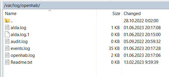

after reboot instruction I can see this:

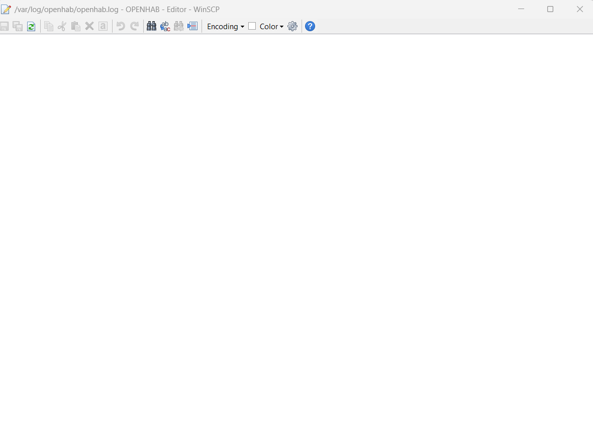

All I can say is that OH isn’t going to delete file willy nilly.
If your openhab.log is completely empty, you’ve messed up your log4j2.xml file and somehow disabled/broke the config for that logger/appender.
It’s weird that only the alda log rotated which additionally points to problems with the log4j2.xml file.
But the rotated file looks to be empty so :man_shrugging:

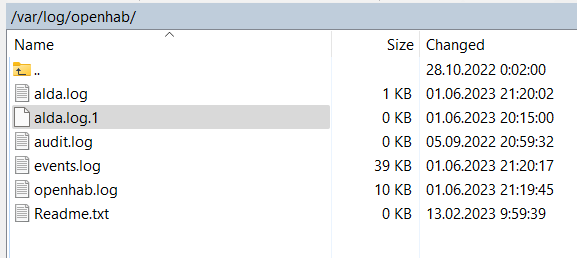

ok after next reboot :
data from alda.log and also openhab.log are lost
File system isn’t full? It’s the last thing I can think of. If it’s not full :person_shrugging: Your machine is simply not healthy and it’s unlikely I at least will be able to remotely diagnose it.
What’s interesting though is this time and the previous time is that openhab.log isn’t empty.
