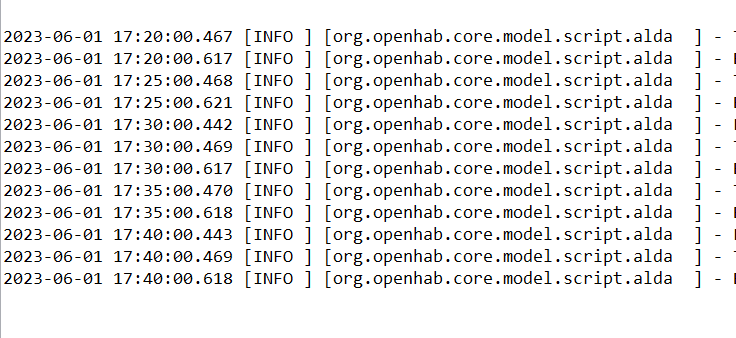

So log is working, BUT there is only few records (opened via WinSCP) :
Don’t know why, but I need much loger time period
a) I do not understand what you would like to do
b) I do not understand what you tried
c) in case the content of the screenshot is of interest I can’t interpret it as the main part is missing ( screenshots might not be good to read depending on the device you use to display them )
d) please be more detailed in describing your problem
I’m writing my own log file but date in the file are only from the time as on my screenshoot - 17:20:00.467 to 17:40:00.618 - but I need all data sent do this log file not only 12 records. Rest isn’t there.

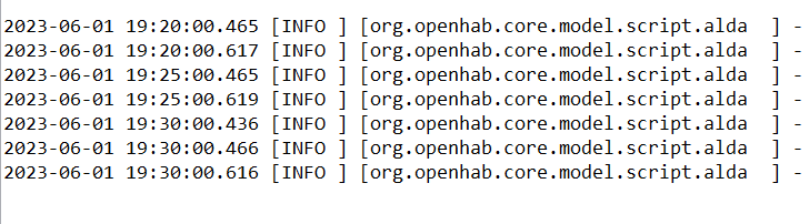

Log saving into alda.log started yesterday evening, but in the alda.log I can see now only this records :
so records which was there (17:20:00.467 to 18:10:00.624) are away
openhab.log is empty
When you restart OH it will rotate the logs. That’s what the OnStartupTriggeringPolicy does. It will also rotate when the log file gets to 16 MB in size.
When it rotates it compresses the old file and adds a number to the file name. For example openhab.log.1.gz.
If you are on openHABian with a default config you have ZRAM configured. In that case all logs are written to a RAM disk meaning they are not saved to the SD card. During a normal shutdown the contents of the RAM disk will be flushed to the SD card. However, if the system crashes or you yank the power, everything written to the logs since the last time the RPi started will be lost.
Completely empty or just empty of logs from this alda rule?
