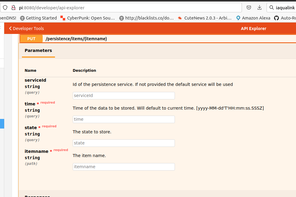

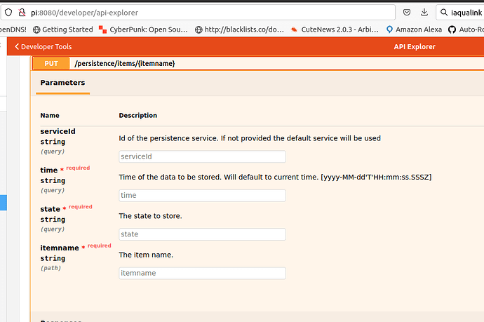

Have a look to the REST API
Screenshot from 2022-07-16 13-15-21
